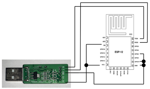

Step 4: How to Wire the Sensor Device
5 Watt solar panel is potentially over designed.
Experience has shown, 250-500 mA panel (5V) is sufficient as long as sun is shining at least a few hours per week.

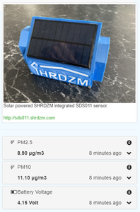

Step 6: Measurements Shown in FHEM...
Step 7: ...in OpenSenseMap...
Step 8: ...or Grafana
