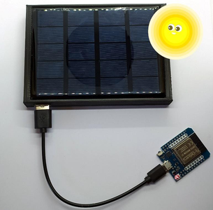

This article introduces a power bank that can be charged via a solar panel.

First, connect the individual modules using connecting wire according to the circuit diagram and solder them in place. Always ensure that the polarity is correct. Now connect the battery and set the output voltage to 5V using the potentiometer on the step-up converter.
The two housing parts are made on a 3D printer. Keep in mind that the power bank will be exposed to the sun for long periods of time and will therefore become quite warm. PLA is not very suitable as this material softens at temperatures above approx. 50 to 60°C and can deform. PETG is more suitable. The picture shows how the individual modules are housed in the case. The status LEDs can be seen from the outside through the slot in the charge controller. The solar module is glued to the frame with double-sided adhesive tape.
