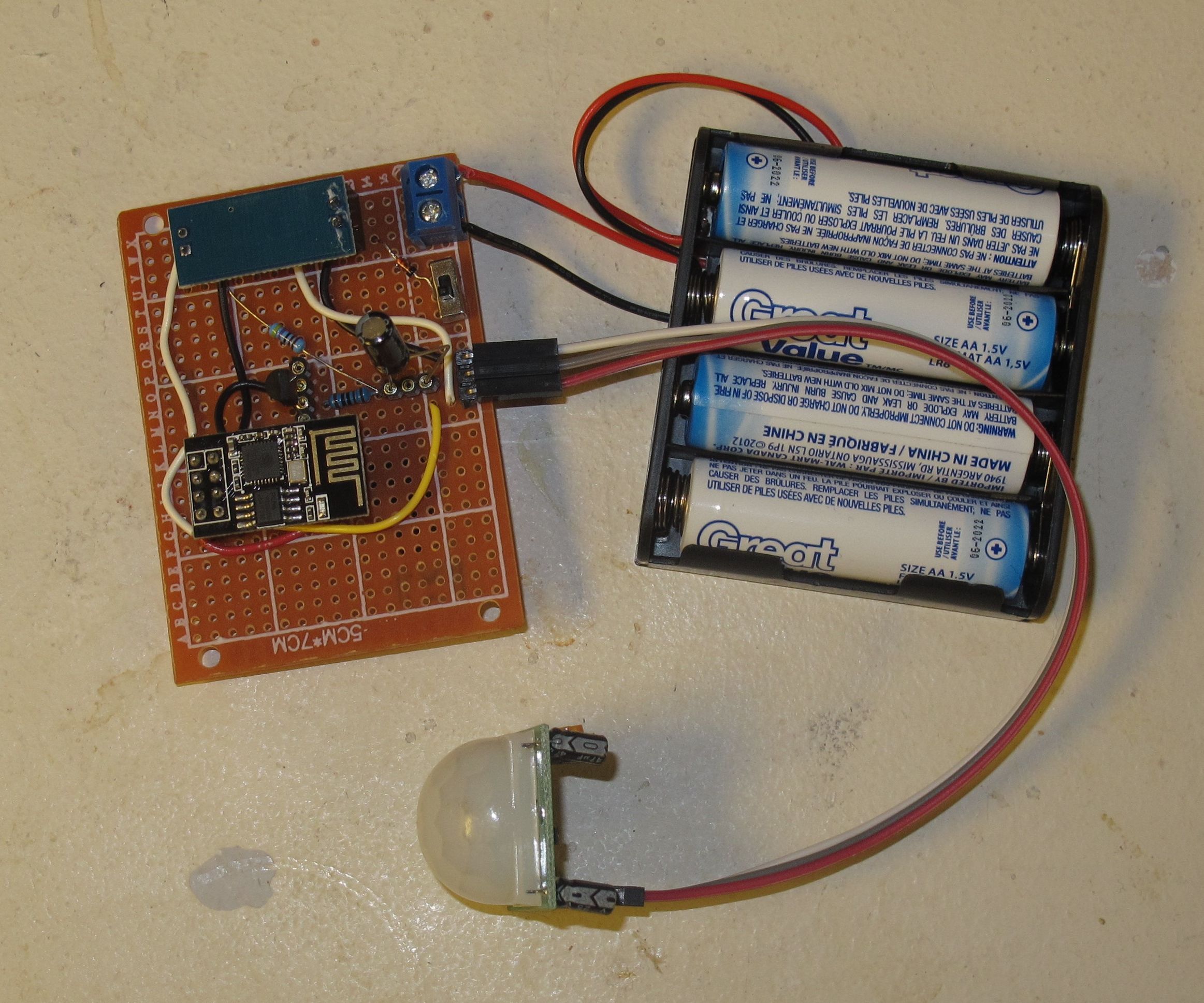

The key aspect of this circuit is using a P channel mosfet to latch the circuit on when a signal is received from the sensor and then having another signal from the ESP-01 keeping the circuit on and the latch in place until the ESP-01 is ready to turn off. Once the circuit is triggered on by the sensor, the circuit stays on, even if the sensor trigger turns off, until the ESP-01 program has completed. This circuit avoids the problem of the ESP-01 being dependent on how long the trigger output of the sensor remains active. Some sensors can have their trigger times modified on the sensor, others are more difficult. With this configuration, a brief active trigger is all that is needed.
Step 1: How It Works
When the sensor is triggered, it will output a positive signal to transistor Q1. (I have used both the radar sensor and a PIR. Both seem to work equally well. The radar sensor is better for outdoor use as it will detect motion through a plastic container and even walls. PIR's are not so functional outdoors where solar power is more suitable.)
When Q1 turns on, it will turn on Q3 through diode D1. When Q3 turns on, the gate of mosfet Q2 will be drawn to ground, turning on the mosfet and allowing current to flow in the circuit to the small 3.3v regulator (used to power the ESP-01).
As soon as the ESP-01 turns on, the Rx pin is set HIGH which will now also apply an active signal to Q3 through diode D2. Now, if the sensor is triggered low, Q3 is still on power still flows through the mosfet and the ESP-01 is kept on. This module will stay on until it's internal program sets the Rx pin LOW and if the sensor trigger is still LOW this will shut off power to the module.
