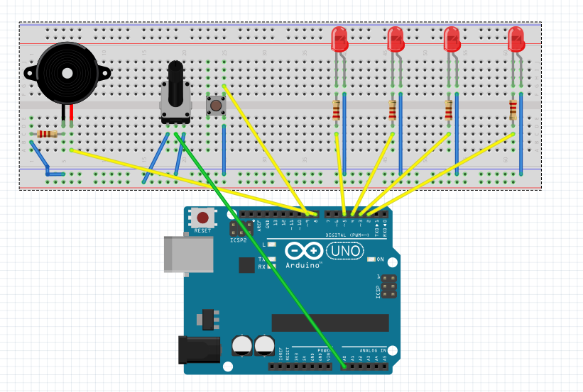

Step 4: Preparing the Arduino
If you want a clear picture of how to connect everything i suggest looking at the included fritzig schema.
Step 1: Connect the i2c adapter to the lcd, solder these two together.
step 2: Connect wires to the bmp180 and plug them in the breadboard, remember to feed the bmp180 with 3.3V not with 5V!!
step 3: Connect wires to the i2c adapter and plug them in the breadboard, use 5V for it.
step 4: Connect the sla and slc wires from the i2c adapter and the bmp180 together.
step 5: Connect the dht21 to 5V and the yellow cable to digital pin 2 on the arduino.
step 6: Connect analog pin 4 to sla, and analog pin 5 to slc, make sure both the bmp180 and the i2c adapter are wired to it.
step 7: Wire the rf transmitter to 5V and digital pin 11 of the arduino nano.
step 8: connect your arduino to your laptop and upload the included sketch arduinoTransmitter
On the lcd you should be able to see the readout of the sensors, because the arduino only reads every 15 minutes, you will only see innit for the first 15 minutes. You can change this polling rate in the arduino file where you see delayInMinuten=15.
