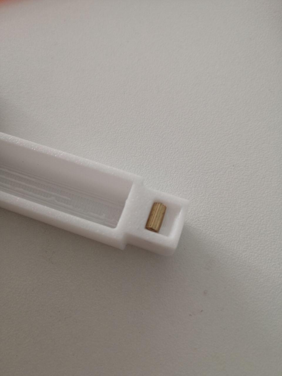

Step 2: Assemble the Case

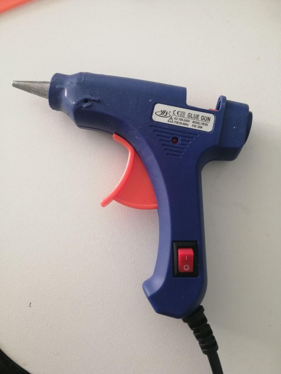

Put 2 long nuts (M2 6mm) inside each side part into special places. Try to tighten two bolts inside each one. Check it tighten freely. Fix each long nut with hot glue gun a little
