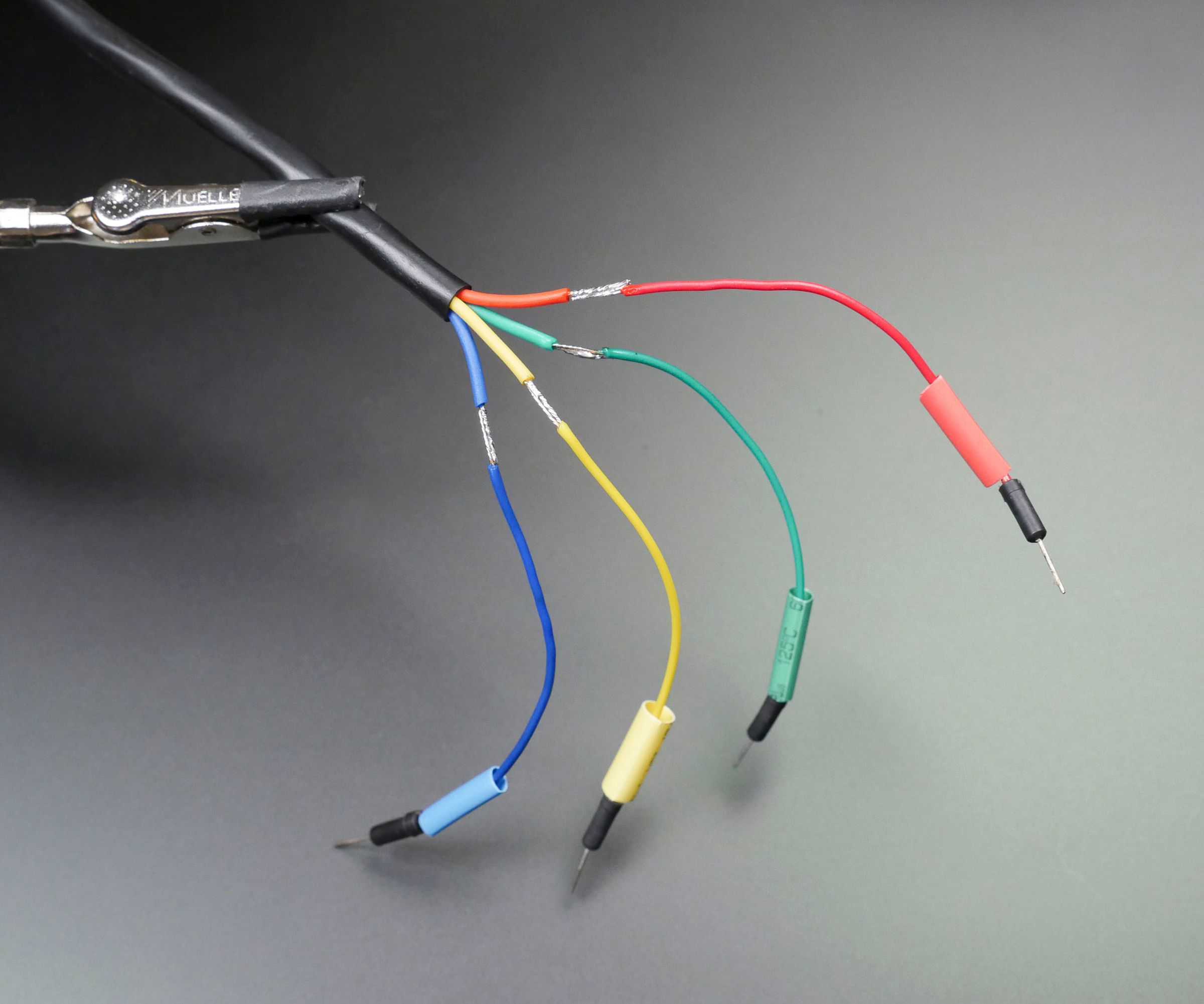

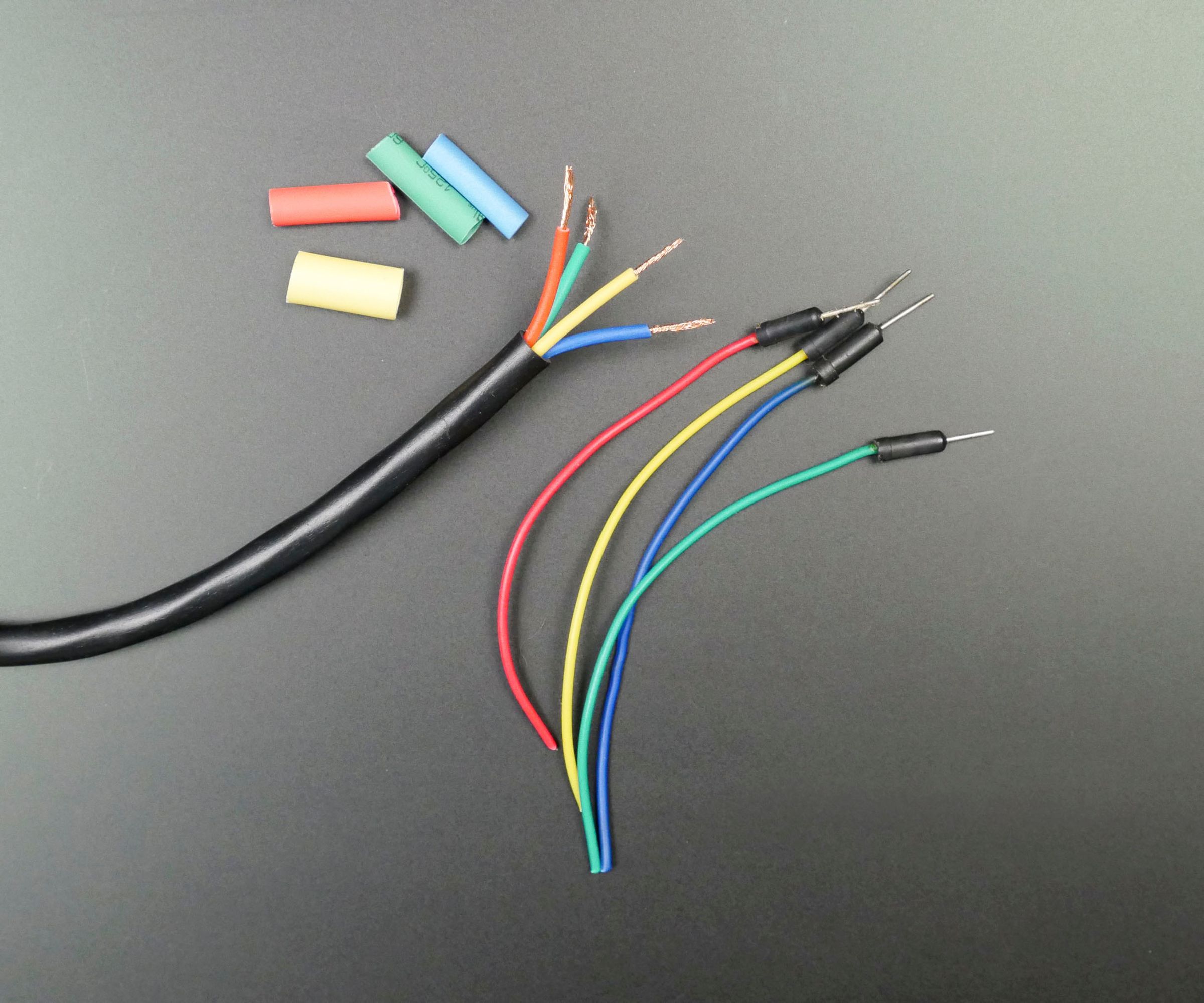

It’s important to create a solderless breadboard prototype for projects like this, so you can make sure your sensor and code are working before making any permanent connections.
In this case, the soil sensor has stranded wires to it was necessary to temporarily attach solid headers to the ends of the sensor wires using solder, helping hands, and some heat shrink tubing.

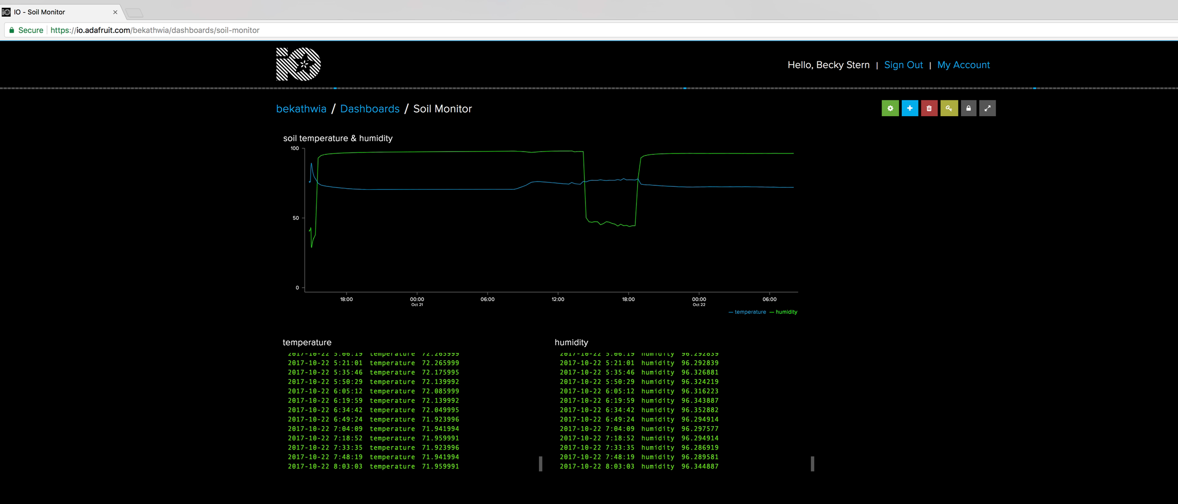

You'll have to do a bit of prep on io.adafruit.com. After creating feeds for temperature and humidity, you can create a dashboard for your monitor featuring a graph of the sensor values and both incoming feeds' data. If you need a refresher on getting started with Adafruit IO, check out this lesson in my Internet of Things Class.

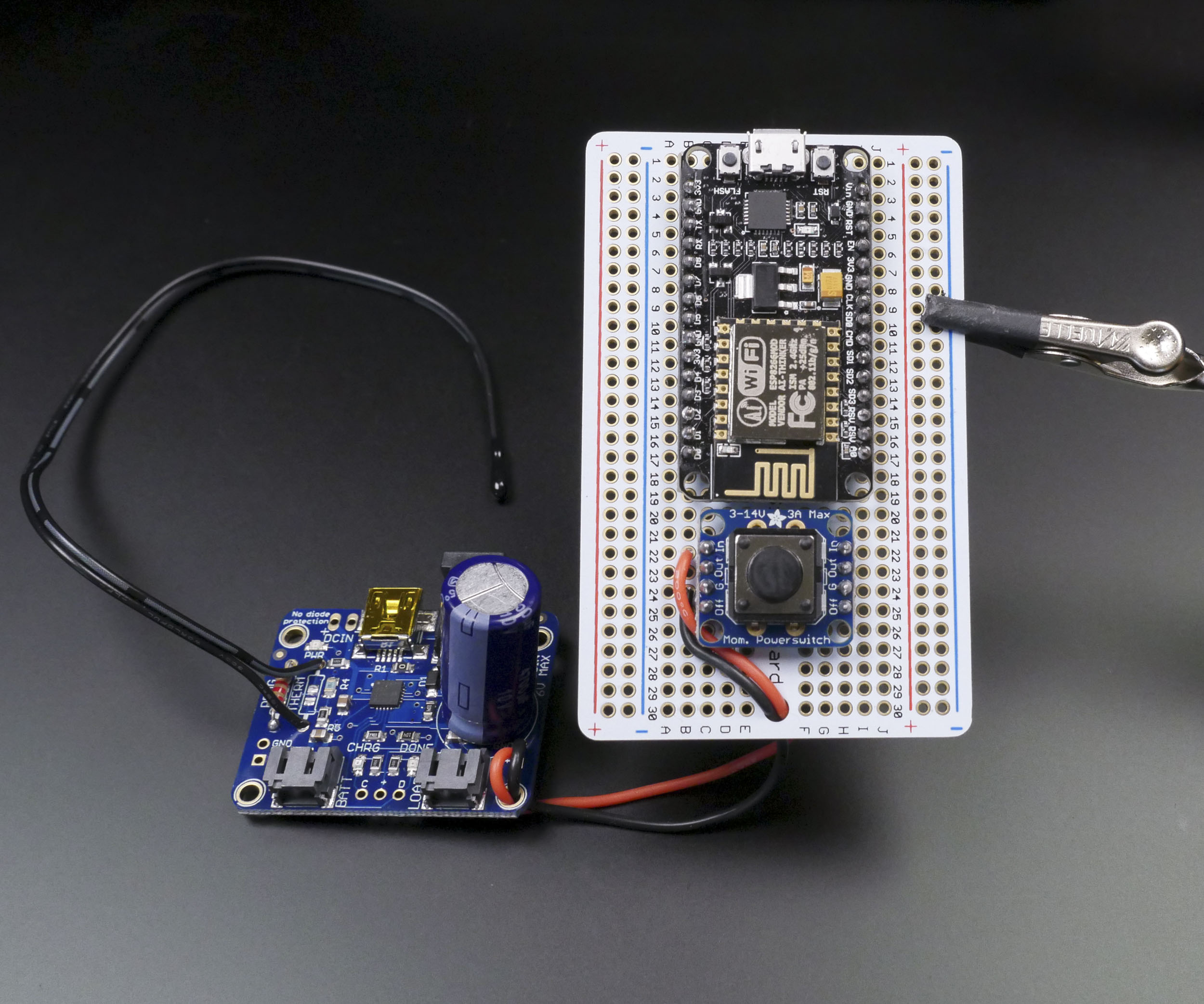

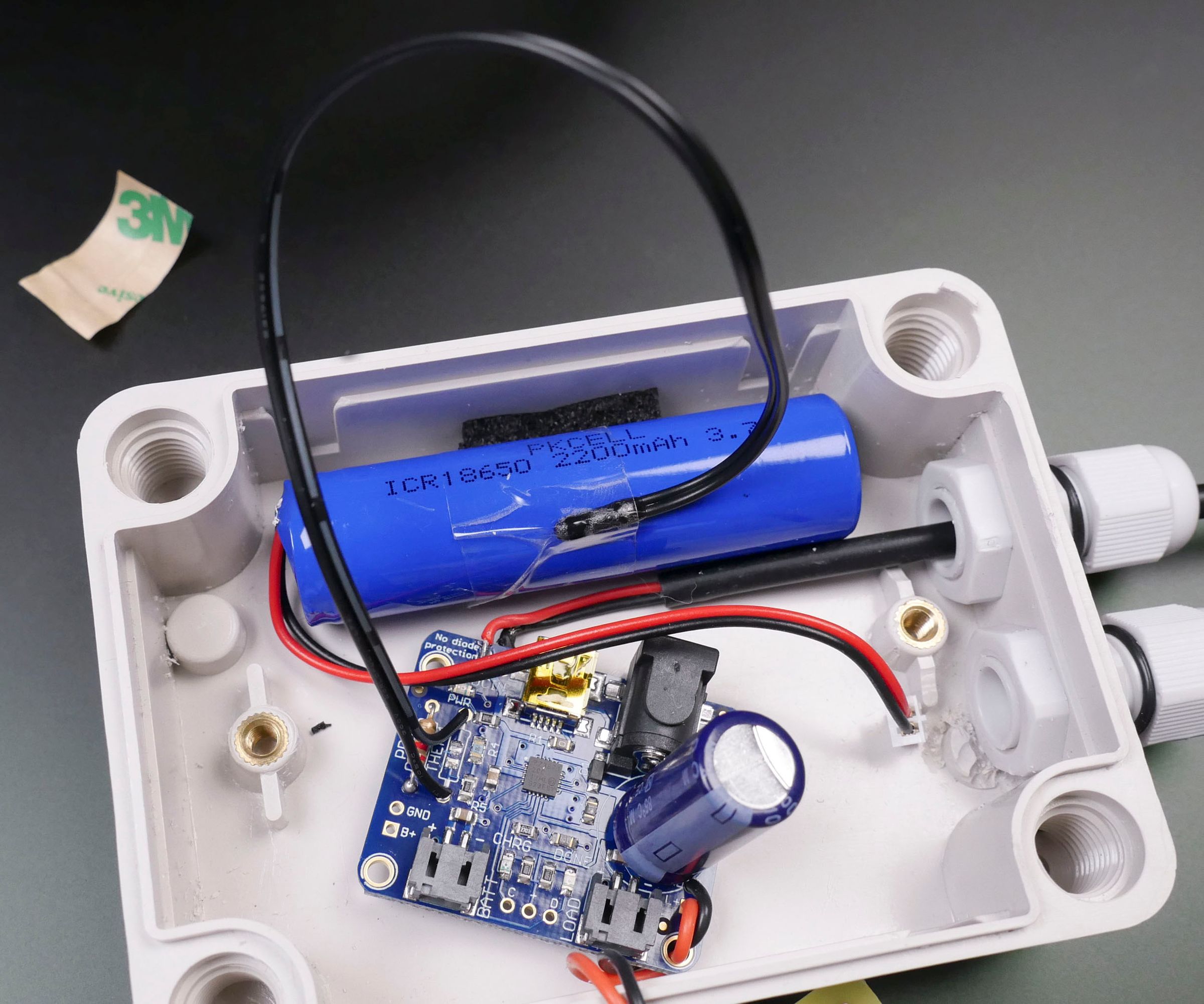

Step 4: Prepare Solar Charging Board
Prepare the solar charging board by soldering on its capacitor and some wires to the load output pads. I’m customizing mine to charge at a faster rate with an optional add-on resistor (2.2K soldered across PROG) and making it safer to leave unattended by replacing the surface mount resistor with a 10K thermistor attached to the battery itself. This will limit charging to safe a temperature range. We covered these modifications in more detail in the previous lesson.

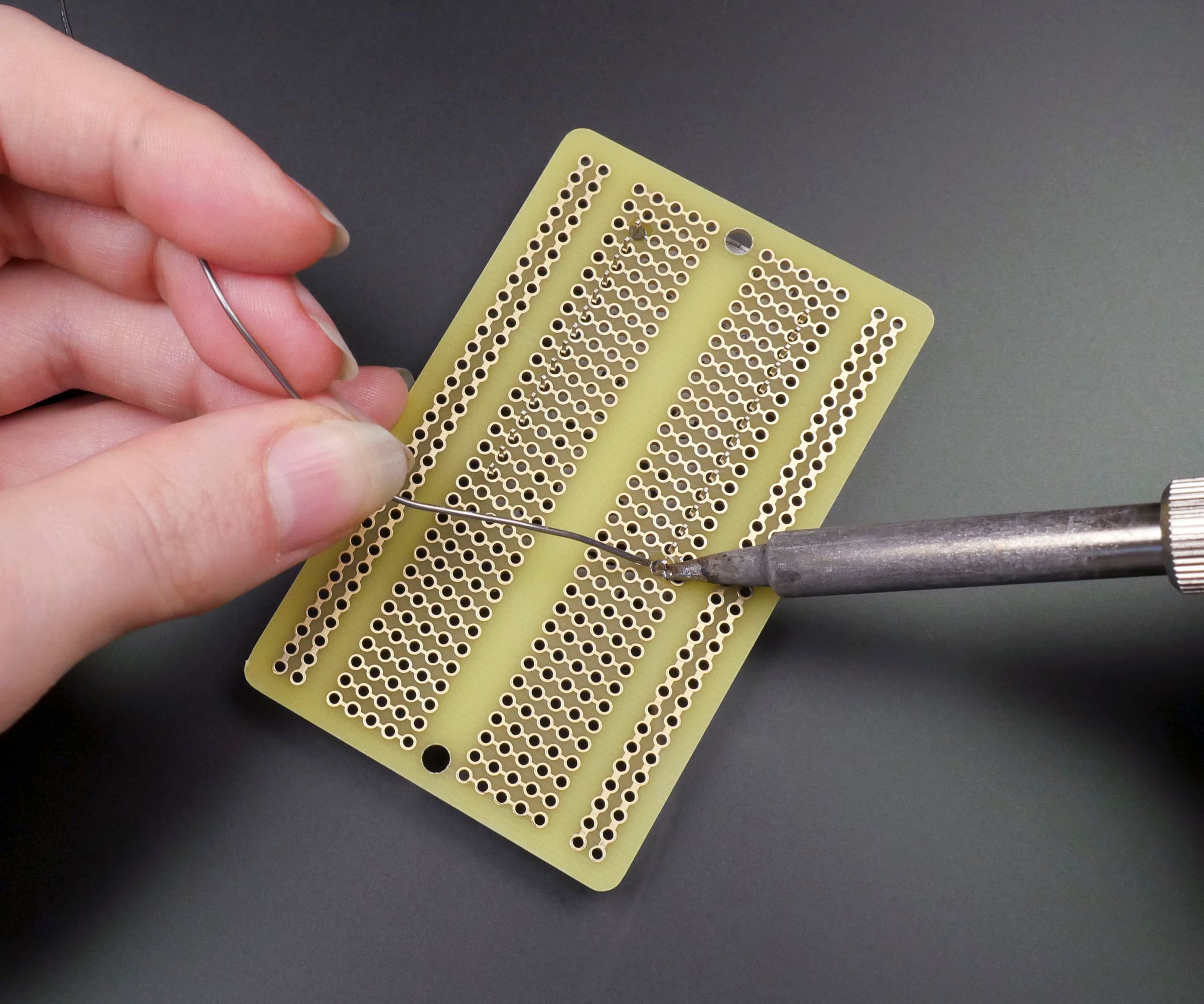

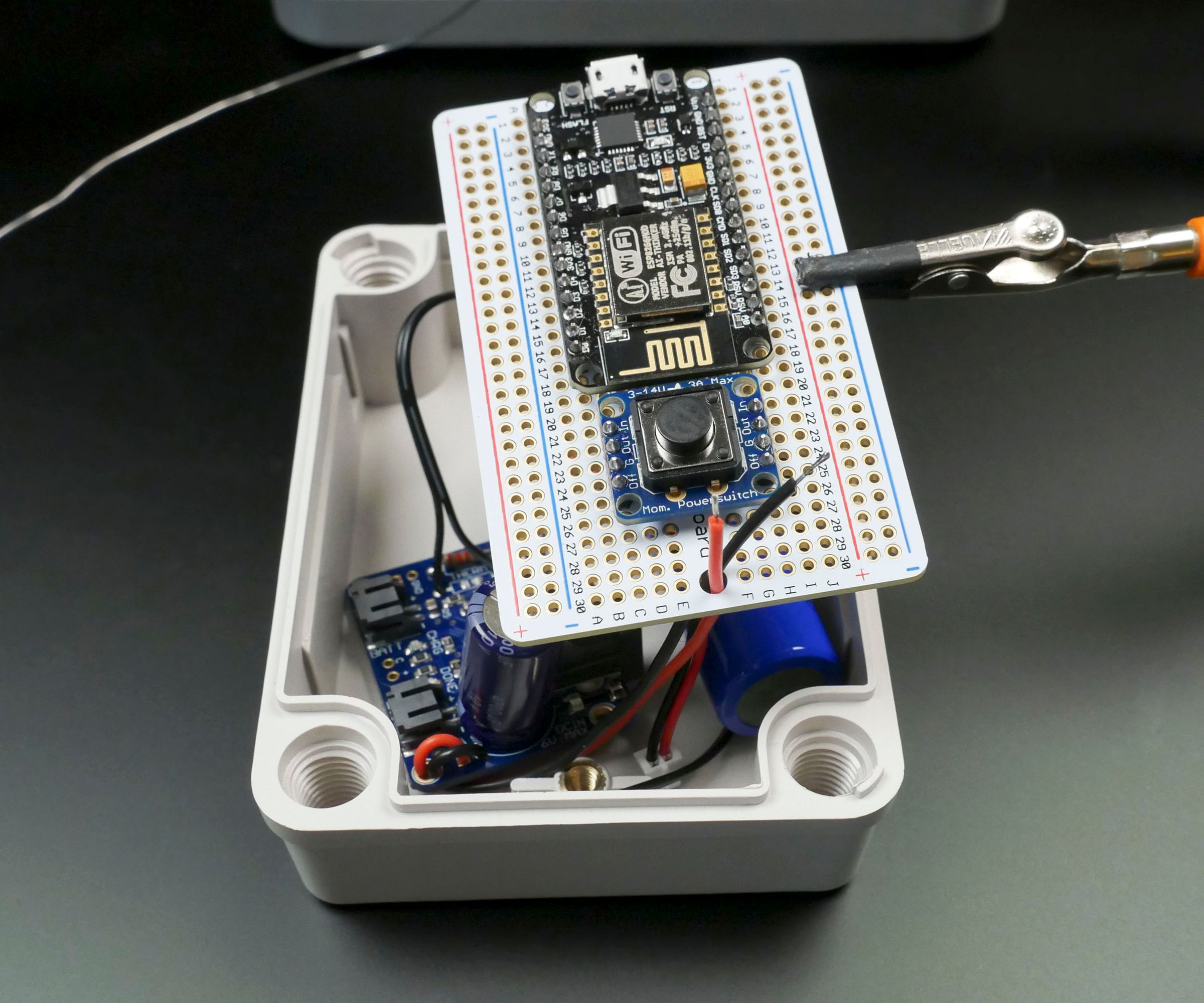

Step 5: Build Microcontroller Circuit
Solder up the microcontroller board and power switch to a perma-proto board.
Connect the solar charger power output to the input of your switch, which should be rated for at least 1 amp.
Create and solder the breadboard wire connections described in the circuit diagram above (or to your personal version's specifications), including the 10K pull-up resistor on the sensor's data line.
The solar charger's Load pins will provide 3.7V battery power when no solar power exists, but will be powered directly from the solar panel if it's plugged in and sunny. Therefore the microcontroller must be able to tolerate a variety of voltages, as low as 3.7V and up to 6V DC. For those requiring 5V, a PowerBoost (500 or 1000, depending on the current required) can be used to modulate the Load voltage to 5V (as shown in the previous lesson). Here are some common boards and their input voltage ranges:

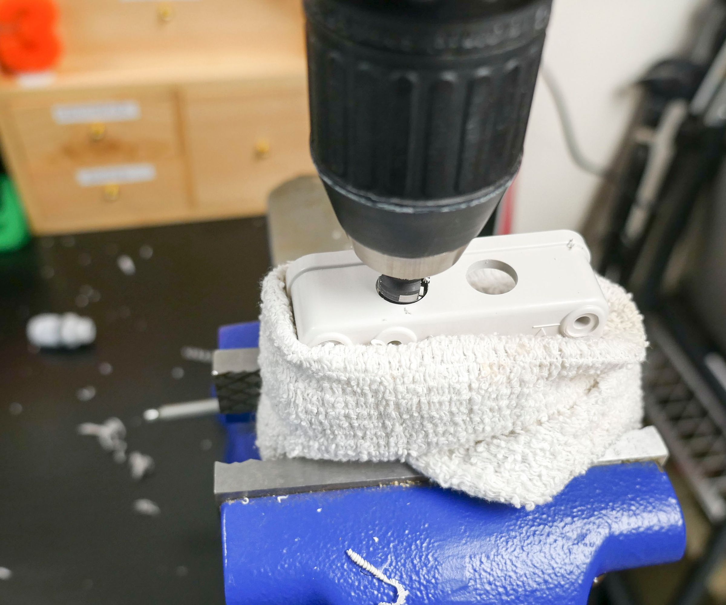

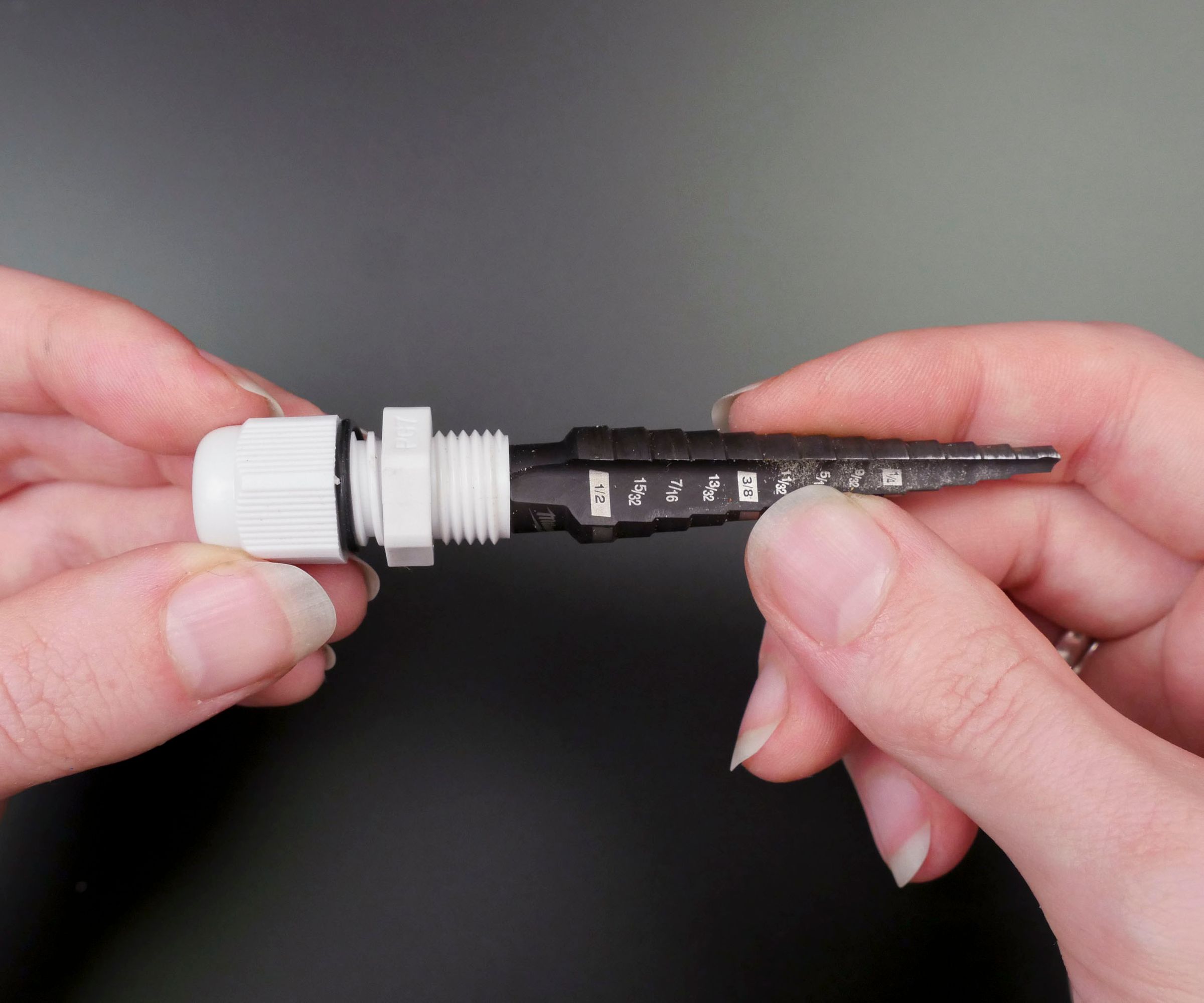

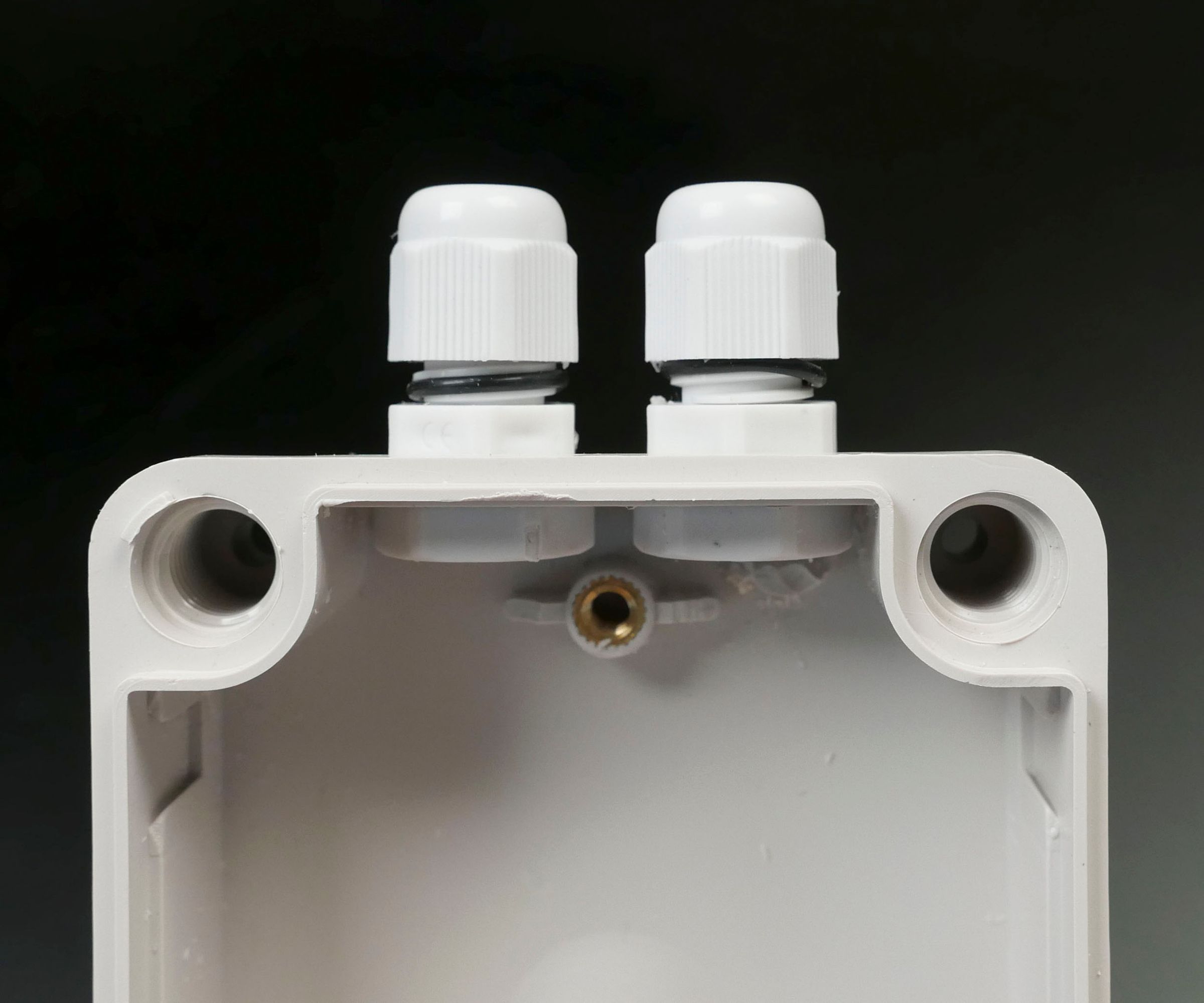

Step 6: Install Cable Glands
To make weatherproof entry points for the solar panel cable and sensor cable, we'll install two cable glands into the side of the weatherproof enclosure.
Test fit your components to identify the ideal placement, then mark and drill holes in a waterproof enclosure using a step drill. Install the two cable glands.

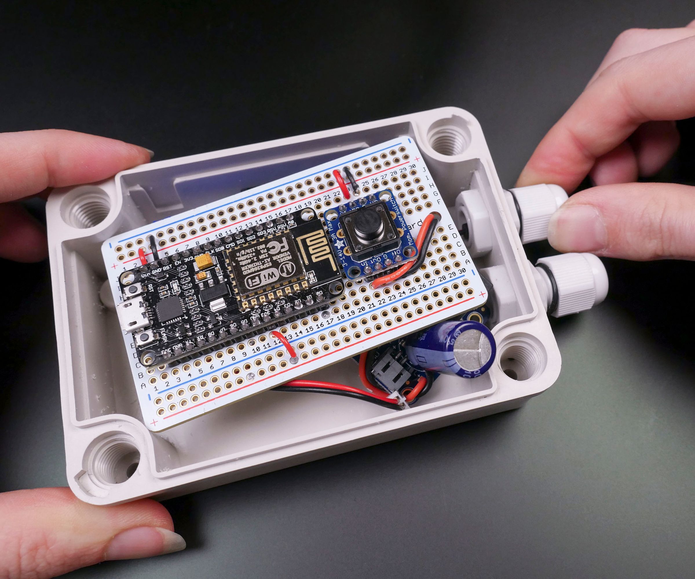

Step 7: Complete Circuit Assembly
Insert the port side of a waterproof power cable into one and solder it to the solar charger’s DC input (red to + and black to -).
Insert the soil sensor through the other gland, and connect it up to the perma-proto as per the circuit diagram.
Tape the thermistor probe to the battery. This will limit charging to a safe temperature range while the project is left unattended outside.
Charging while too hot or too cold could damage the battery or start a fire. Exposure to extreme temperatures can cause damage and shorten the battery's life, so bring it inside if it's below freezing or above 45℃/113F.
Tighten the cable glands to make a weatherproof seal around their respective cables.

Test it out and be sure it's reporting to the internet before closing up the enclosure and installing the sensor in your herb garden, precious potted plant, or other soil within signal range of your wifi network.

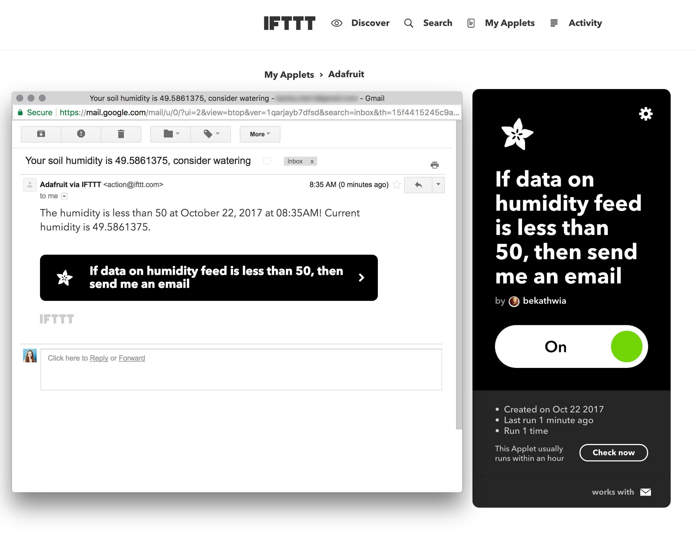

Once the data from the sensor is being logged online, it’s easy to set up a recipe for email or text alerts on the API gateway site If This Then That. I configured mine to email me if the soil moisture level drops below 50.
To test it without waiting for my plant to dry out, I manually entered a data point to my humidity feed on Adafruit IO that fell below the threshold. A few moments later, the email arrives! If the soil's levels fall below my specified level, I'll get an email every time the feed is updated until I water the soil. For my sanity, I updated my code to sample the soil much less often than every 15 minutes.
