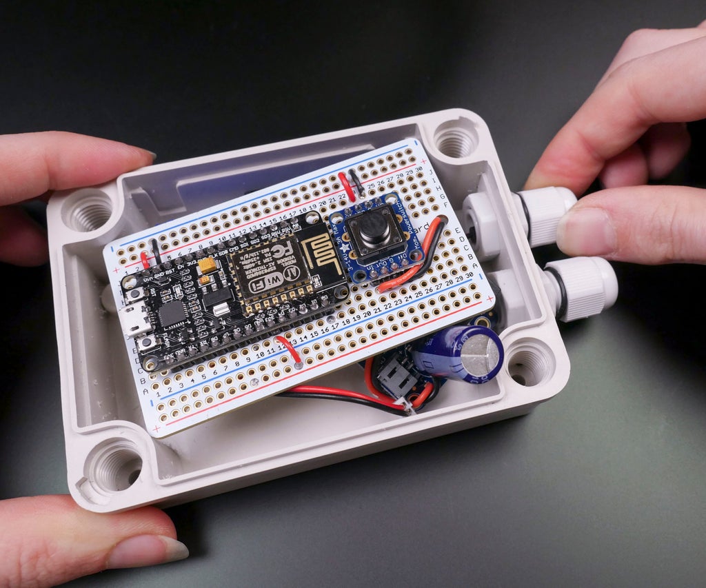

Step 4: Prepare Solar Charging Board
Prepare the solar charging board by soldering on its capacitor and some wires to the load output pads. I’m customizing mine to charge at a faster rate with an optional add-on resistor (2.2K soldered across PROG) and making it safer to leave unattended by replacing the surface mount resistor with a 10K thermistor attached to the battery itself. This will limit charging to safe a temperature range. I covered these modifications in more detail in my Solar USB Charger project.
Step 5: Build Microcontroller Circuit
Solder up the microcontroller board and power switch to a perma-proto board.
Connect the solar charger power output to the input of your switch, which should be rated for at least 1 amp.
Create and solder the breadboard wire connections described in the circuit diagram above (or to your personal version's specifications), including the 10K pull-up resistor on the sensor's data line.
The solar charger's Load pins will provide 3.7V battery power when no solar power exists, but will be powered directly from the solar panel if it's plugged in and sunny. Therefore the microcontroller must be able to tolerate a variety of voltages, as low as 3.7V and up to 6V DC. For those requiring 5V, a PowerBoost (500 or 1000, depending on the current required) can be used to modulate the Load voltage to 5V (as shown in the Solar USB Charger project). Here are some common boards and their input voltage ranges:
- NodeMCU ESP8266 (used here): 5V USB or 3.7V-10V Vin
- Arduino Uno: 5V USB or 7-12V Vin
- Adafruit Huzzah ESP8266 Breakout: 5V USB or 3.4-6V VBat
In order to achieve the longest possible battery life, you should take some time to consider and optimize the total current your current draws. The ESP8266 has a deep sleep feature which we used in the Arduino sketch to reduce its power consumption dramatically. It wakes up to read the sensor and draws more current while it connects to the network to report the sensor's value, then goes back to sleep for a specified amount of time. If your microcontroller draws a lot of power and can't easily be made to sleep, consider porting your project to a compatible board that draws less power. Drop a question in the comments below if you need help identifying which board could be right for your project.
Step 6: Install Cable Glands
To make weatherproof entry points for the solar panel cable and sensor cable, we'll install two cable glands into the side of the weatherproof enclosure.
Test fit your components to identify the ideal placement, then mark and drill holes in a waterproof enclosure using a step drill. Install the two cable glands.
Step 7: Complete Circuit Assembly
Insert the port side of a waterproof power cable into one and solder it to the solar charger’s DC input (red to + and black to -).
Insert the soil sensor through the other gland, and connect it up to the perma-proto as per the circuit diagram.
Tape the thermistor probe to the battery. This will limit charging to a safe temperature range while the project is left unattended outside.
Charging while too hot or too cold could damage the battery or start a fire. Exposure to extreme temperatures can cause damage and shorten the battery's life, so bring it inside if it's below freezing or above 45℃/113F.
Tighten the cable glands to make a weatherproof seal around their respective cables.
