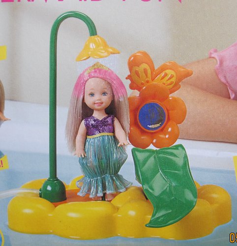

Step 14: Knitting Thermochromic Doll Hair..
It is very hard to find and buy continuous strands of thermometric fibers, and it has to be continuous. You need yards and yards of material for knitting, otherwise there would be knots and ends all throughout your knit from tying strands together. This particular plastic material is actually used for making doll hair. I combined two colors, a blue that changes to dark violet under extremely cold conditions and a pink that turns white above room temperature, in order to create a wider thermochromatic range.
