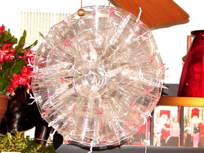

Like cousins No-Melt Sparkleball and Sparkleball Mini, Solar Star Sparkleball is a handmade light ball made of plastic cups and Christmas lights. The big difference: the lights are little icicles powered by a solar panel. Arranged in a sparkleball, the icicles make a star shape and give off a starry, snowy light. Lovely in trees! (For a kid's project, adapt directions using the No-Melt method.)

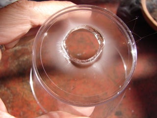

Using a hot soldering iron, melt a hole 1/2 - 3/4" in the bottoms of 25 cups. Test first hole to make sure you can slide icicle light through.

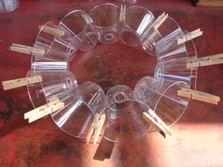

Arrange 12 cups into a circle. Clip together with clothespins. ( Scatter the cups with holes. ) With hot soldering iron join the cups to form a ring. The best method is to melt cups together at their bases (through cup walls). Hold joint til cool. Work around the ring.

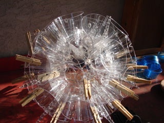

In the space open at the top of the dome, insert the last four cups. Fit them into the space at the same time. Hold them with clothes pins. Solder the cup bases to as many other cups as you can. The more joints the sturdier the sparkleball. When the half is complete, you can reinforce it by melting joints wherever the cup rims touch. (See notches in photo) You have half a sparkleball.
Step 6: Build Second Half Same As First
Set the completed sparkleball-half aside, and build a second one just like it.

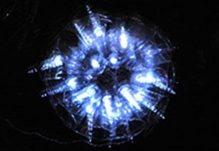

If the lights are loose in the cups,  you can hotglue them into the center.  The effect you want (if you use the icicle lights) is like a star, with the icicles pointing outward from the cups.

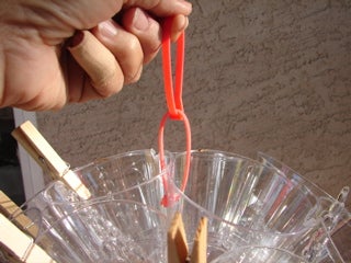

Make a hanger for the sparkleball by melting holes in three of the cups, and looping zipties through.

The icicle light directions call for 8 hrs charging in sunlight.  Make sure you read the directions for your solar lights and follow them carefully.  If properly charged,  your sparkleball will shine all night long.   The panel will need a new rechargeable battery once a year.   In the photo, the little solar panel is resting on top, but it can hang down.
