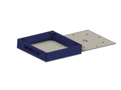

Step 1: 3D Print the STL Files
Designed in Fusion360 Software.

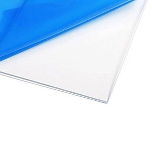

Step 2: Cut and Paint the Acrylic Sheet
1. Cut the 3mm Acrylic Sheet to the size of 145mm X 145mm.
2. Use Black acrylic colour for Painting the one side of acrylic sheet.

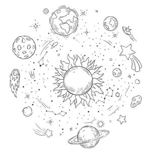

Step 3: Engraving the Sheet
Here I am providing files.
1. Solar System Image
2. SVG Image
3. DFX Image
4. G-code
Note 1: Engrave on the side where you have painted the sheet. Don't remove the protection film on other side until you completes all things.
Note 2: If you know how to edit G-code then only use it otherwise not.

Step 6: Put the LEDs Holder in Mani Body of Lamp
Step 7: Insert the DC Female Jack to Back Lid and Solder Its Wire to LEDs
Refer the above Images.
Step 8: Insert the Acrylic Sheet to Lamp Body
Decorate as per your choice. I use beads strips on the boundary.
Now remove the protection film from Acrylic sheet.
