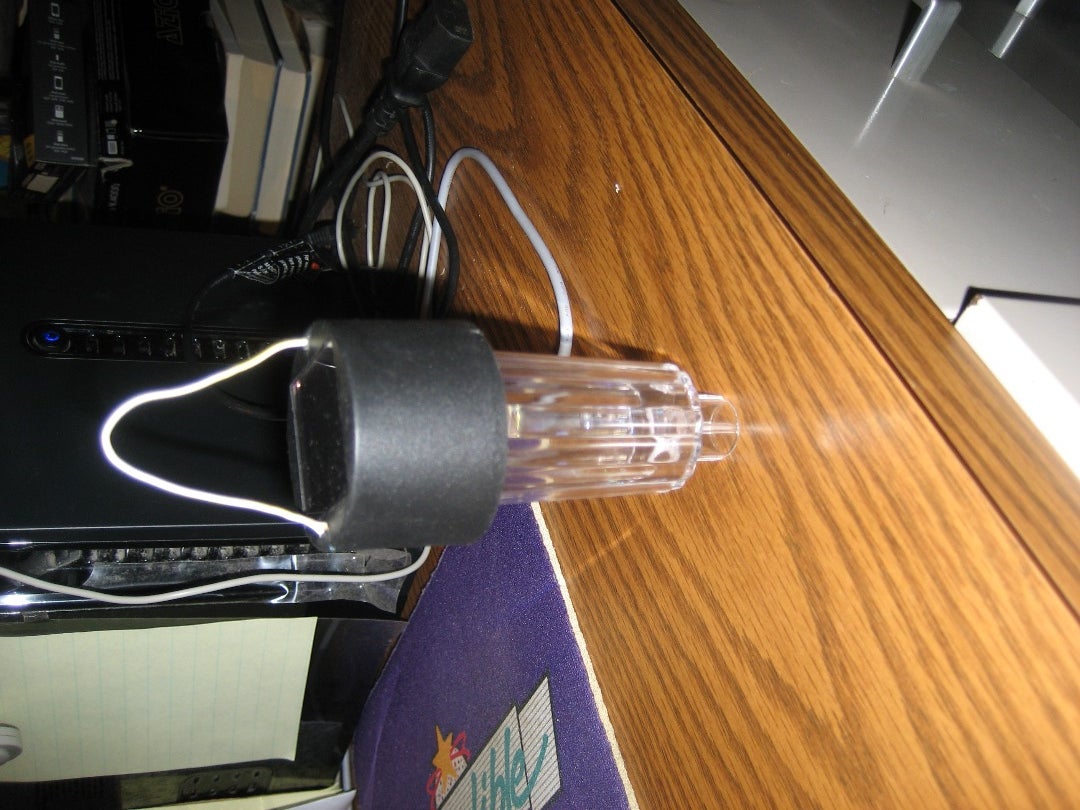

Step 3: Add Hanger
- Now drill 2 holed in the top and use some insulated wire - about 4 - 6 inches - to make the hanger loop. Use knots on the inside to hold it in place. You may do this later, too.
- I installed the switch on the lead coming out of one of the battery terminals. The switch has leads about 2" long so that it was glued to the outside of the cap and the leads fed inside through an existing slot (for the paper strip)in the cap.
Step 4: Reassemble
Now put the light back together using the 3 screws.
Twist on the globe.
Turn the switch on and the LED will light up.
If not, charge it for a few hours in the sun I believe that the switch needs to be on during charging so that the current will flow in to the battery.
The acrylic globe is not really necessary but it seems to protect the LED and the switch.
