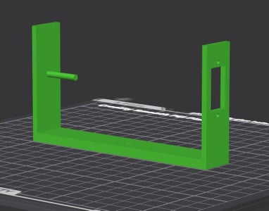

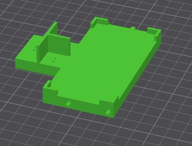

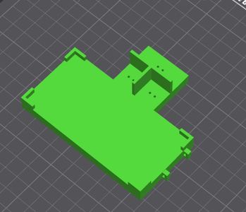

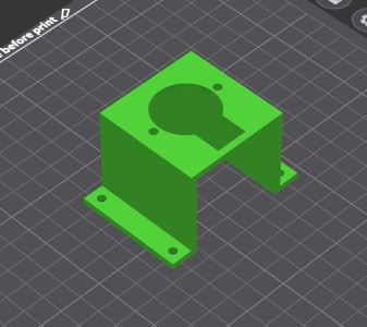

Step 1: Print the Pieces of the Solar Tracker
You have to print 3 pieces :
  1. the stepper motor support which will be screwed to the plank
  2. the servo motor support which will be fit into the shaft work of the stepper motor
  3. the panel support

First, you can screw your stepper motor support on the plank. Insert the stepper motor in the support and screw it with two nuts (photo 1).
Fit the propeller of your servo motor in the panel support (photo 2).
You must screw the servo motor on its support (photo 3) and insert the hole of the panel support in the rotation axis of the servo motor support (photo 4). Then fit the propeller in the stepper motor (photo 5).

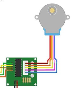

Step 3: Electrical Assembly
This is the most important part of the project. You have to reproduce the numerous connections as in the plan.
In the wiring diagram, the left photoresistor is "R1" of the photograph. On the right, the upper one is "R2" and the bottom one is "R0".
The piece at the top of the wiring diagram is the controller of the stepper motor. It is on the other image (taken from https://joy-it.net/files/files/Produkte/SBC-Moto1/SBC-Moto1_Manual_2024-05-08.pdf).
The electrical assembly measures the voltage at the photoresistor terminals with voltage dividers. By using the arduino code (following section), the arduino board controls the stepper motor and the servo motor to orient the panel towards the sun.
