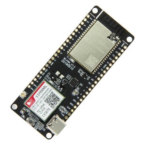

OK, power is solved. But what will be the brain of this operation? To satisfy my desire to have portable weather station I've decided to go with LILYGO T-Call version 1.3, later on version 1.4 module with ESP32 and SIM800L module. LILYGO module comes with antenna and wires for power. Espressif ESP32 will be the brain which will contain program code. In SIM800L communication module I'll add SIM card that will connect to GPRS mobile station with APN information and send collected data to a web server. Big note, if you are planning to use SIM800L module check that your mobile operators in your country are still supporting 2G, GSM, GPRS networks. This will not work with 3G and higher generations if GSM is not supported. I'll buy cheapest mobile data package for SIM because sending of weather data will need very little internet data. In one week this weather station should not create traffic more than 100MB if sending data in period of 15 to 30 minutes.

For start, I will solder pins to LILYGO board and sensors.
Once I saw sensor readings are working I've decided to transfer all this to perfboard, add all sensors that I mentioned before in this tutorial and let's connect everything to work as we want.
Get all the components and wire them like I did on this scheme. Working with perfboard was so messy and often I connected 2 or more pins I shouldn't connect because they were so close to each other.
Just to give you an example, I didn't see but I soldered SCL line of sensors to ground pin and I2C was not working. I spent day and a half looking and searching why I2C communication is not working until I saw those pins that should not be connected were connected. That was a reliving moment for me. :) So be careful if you are planning to use perfboard the same way I did. Other option, which would be better and cleaner, would be to make PCB board and then just solder pins that will hold module and sensors on it. Maybe I will make that in future. We will see.
One very bad thing that happened in this process of making this weather station. In one point of making I wasn't careful and burned LILYGO module. No problem. I've ordered another one. But, to arrive, it will need more than a month. That's why I decided to include Wemos D1 Mini Pro module with ESP8266 in this project. I've prepared the connections for it and was planning to use it until new LILYGO module don't arrive. But on the end I decided to leave all the pins for Wemos so now, I have a option to switch between the two modules.

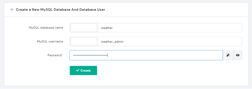

You can use development environment like XAMPP or WAMP to create web app locally or buy public web server and domain from some hosting. As I mentioned before you can't send sensors data to local web server unless you setup DynamicDNS for it, or you have a static IP that is publicly available from internet. I will work with public web server in this tutorial.
Let's prepare MySQL database and PHP files for web app. In database you want to create table with primary key, values for sensors and timestamp. Let me mention again that full code is available in tutorial description.
As a base we have this code here, again from RandomNerdTutorials project. I've just added few more fields for all sensors data. I created index.php and added some cool stuff in there. I wont go through the code. Just replace this and add yours database information and API key same you have in C++ code. Then we will need to add database information to post-data.php file. Let me just mention that data is sent from ESP32 and SIM800L module with a HTTP POST request to post-data.php.
