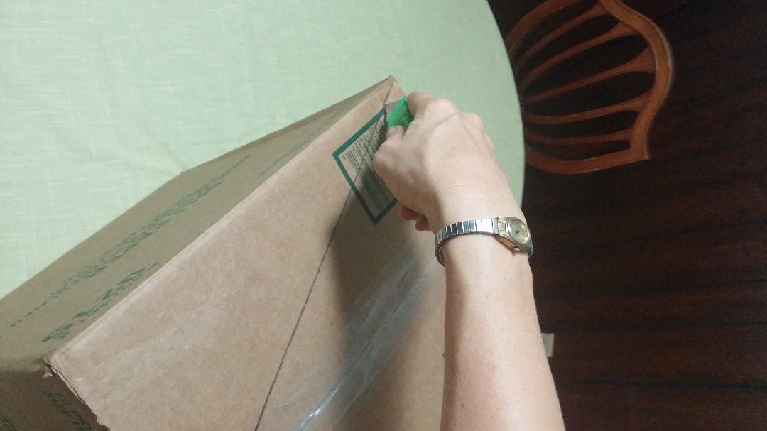

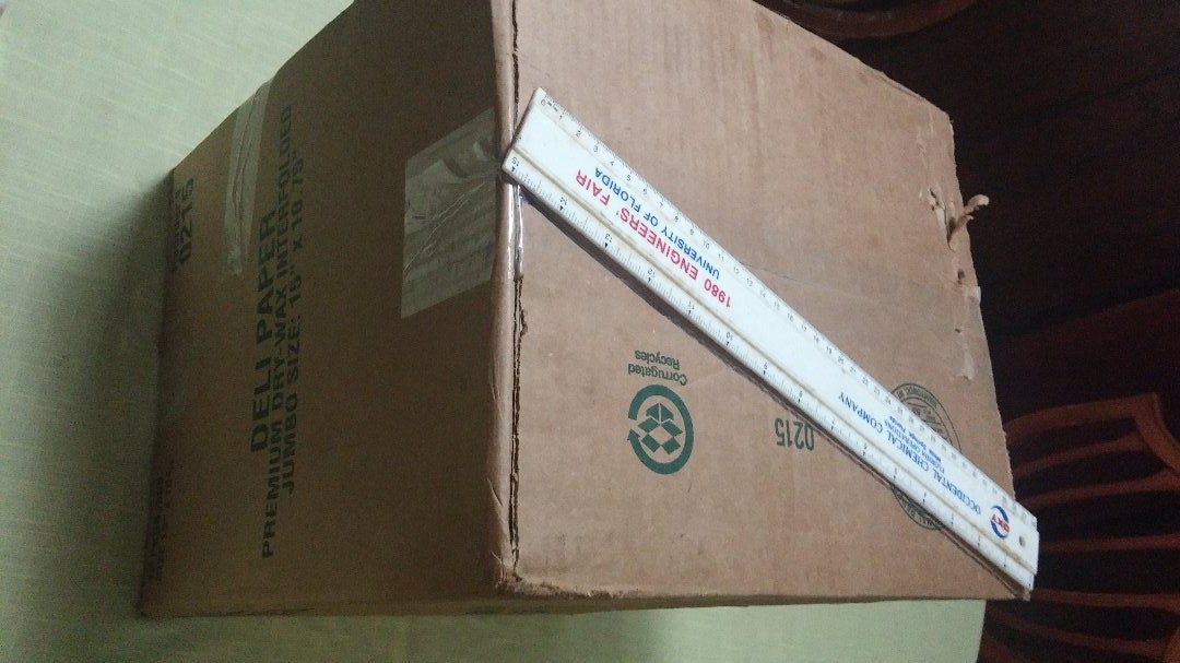

Step 2: Draw Line on Box Top
With the box top closed, using the straight edge and pen draw a line from the upper right corner to the midline of the box.
Step 3: Cut the Box Top
Using the box cutter cut the box top along line.
Step 4: Draw Line on Box Side
Using the straight edge draw a line down the midline on the side of the box to meet the cut made in the top of the box.
Step 5: Cut Side of Box
Cut down the side of the box along the line.

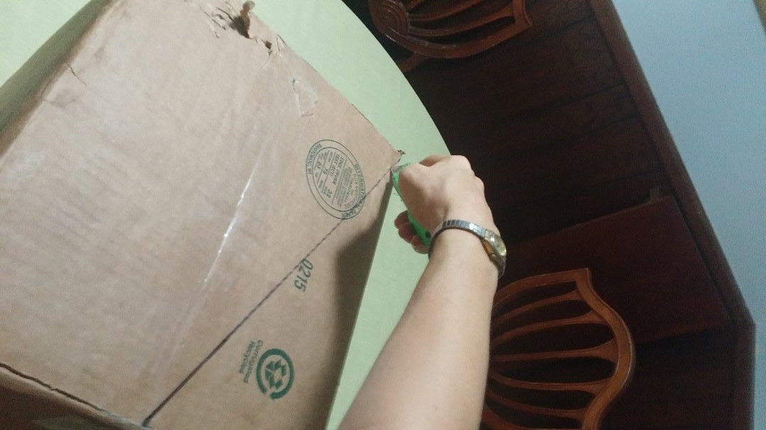

Step 6: Draw and Cut Bottom of Box
On the bottom of the box, again using the straight edge, draw a line from the upper left corner to the midline of the box to meet the cut made on the side of the box.
Cut along the line.
Step 7: Open the Box Up
Open the box up along the newly cut lid. Glue the flaps inside the sides of the box together using the white glue.
