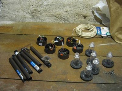

Step 1: What You Will Need
A local discount hardware store had solar walkway lights for $4 each. They were Westinghouse 474005-78 models. You don't need to get exactly these, but these were ideal for this purpose. The light consists of a cap which has the solar panels and a photocell on the top, and contains the battery, recharging circuit, and LED inside. The LED faces down into a clear plastic shell, which is on top of a stalk that stakes into the ground. The top cap is easily removed from the shell, and the stalk pops right off.
The ornaments I will make keep the solar panel, battery, and LED circuitry module in one piece, and add a long "extension cord" to the LED itself, so the LED can illuminate an ornament of some kind and still be far away from the solar panel. With this model of walkway light, it's a bonus that the little clear shell easily detaches and makes its own ornament, so you can add a long wire to the LED and re-assemble the original clear shell around the LED, so that the ornament practically makes itself. If you use a different model walkway light, you can still move the LED away from the solar panel, but you may need to get (or make) a transparent ornament for the LED to illuminate.
The LED is connected to the circuit by its own leads, which are about 2cm long. That means that you don't need to desolder anything to get this to work - just clip the wires to the LED and splice in 3 or 4 meters of wire , so the LED is far away from the solar panel.
So, in addition to the walkway light(s) you will need some thin comm wire, like CAT-5 or something. I found a 100-foot modular telephone cord for $1, so that's what I used in this case. The phone cord has 4 conductors, so I could use one length of wire for two walkway lights. The stuff was cheap, but it's hard to strip and not easy to solder, but it did the trick.
You will also need some stiffer wire, like bell wire or steel picture-hanging wire to hang the final ornament from the tree.
Because this will be outdoors, you will need silicone caulk to weatherproof it. I also decided to try some Liquid Electrical Tape this time instead of my usual black electrical tape, but quite frankly I would not recommend it - just go with electrical tape.

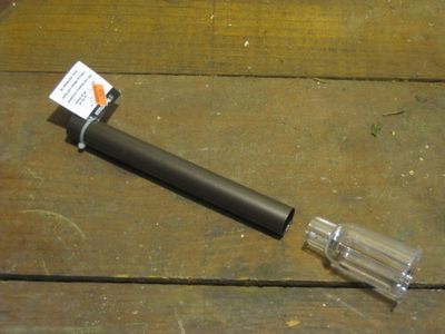

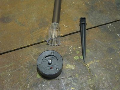

Step 2: Disassemble the Walkway Light

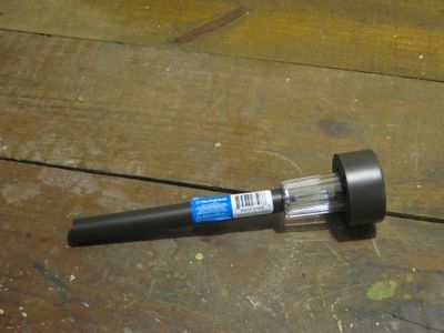

Remove the clear shell, stalk, and stake point from the top cap. For this model of light, you just turn the top cap a quarter turn and lift it off.
Pull the stalk from the clear shell. The stalk will not be used for this project, and can be discarded or used in another project.

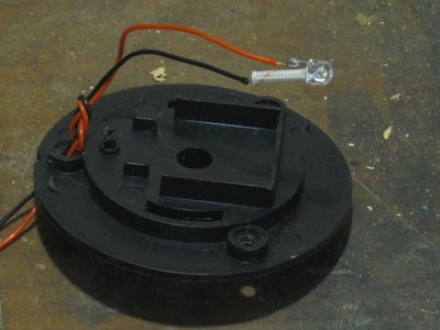

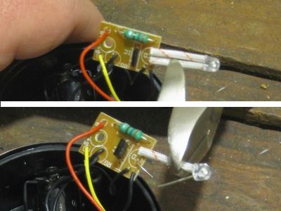

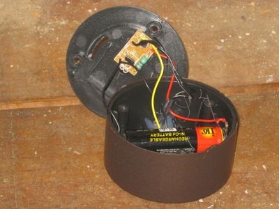

Open up the top cap, exposing the circuit and battery. Note the little plastic strip in the battery holder to prevent the battery from discharging in the store. Don't forget to remove this later!
Cut or melt the plastic tabs that hold the circuit board to the plastic case, and pull the circuit board away from the case (don't break the wires).
Pull the LED out of the plasic case so that the two halves of the plastic case can now be separated. The LED is held in place by a blob of hot glue, and should just pop right out.
When you are done, you will be left with the clear shell, the top of the top cap with the battery inside it and the circuit board and LED dangling from it, and the bottom of the top cap which has a hole where the LED was.

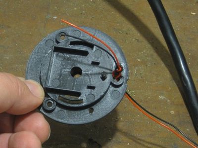

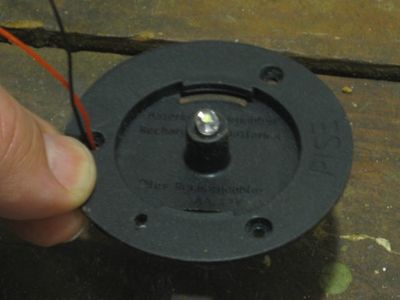

Step 3: Splice Extension Wire for the LED

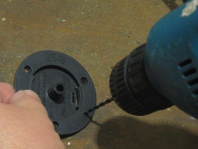

Take the plastic cap half with the LED hole in it and turn it LED-side up. There are three screw holes at the 12 o'clock, 4 o'clock and 8 o'clock positions on this plastic case.
Drill a small hole at the 6 o'clock position.
Feed the LED extension wire through the hole at the 4 o'clock position, so that there's about 3cm of wire sticking through the other side, and tie a big knot in the wire so that it can't pull back through the hole.

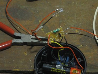

Clip the leads to the LED, separating it from the circuit board. Here's a tip - whenever I cut leads like this, I always cut on one lead close to the circuit board, and the other close to the LED. This way, the LED has one long and one short lead, and the circuit board has one long and one short lead. When you splice the new length of wire between the LED and the circuit board, the wire from the LED's long lead goes to the circuit-board's short lead, and the LED's short lead goes to the circuit-board's long lead. This way, it's nearly impossible to get the polarity wrong on either end of the splice, since the length of the leads will tell you which wire goes where. Also, when you tape up the splice with electrical tape, the wire's cuts are separated and won't short out - the insulation from one wire is always next to the bare splice of the other.
Splice in your 3-4m extension wires and solder them.

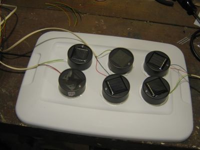

Step 4: Mount the Solar Panels and Batteries
Now that there is a lot of wire separating the circuit board and battery from the LED, mount the entire solar panel assemblies to something. In my case, I used a plastic lid from a storage bin. I used screws to go through the bin lid and into the original screw holes in the top cap.
REMOVE THAT LITTLE PLASTIC TAB FROM THE BATTERY HOLDER!
Use silicone caulk to seal around the edges of the solar cell cases, especially where the wire leading to the LED sticks out.
Set the board of solar panels aside to dry (it needs a whole day to set up and cure).

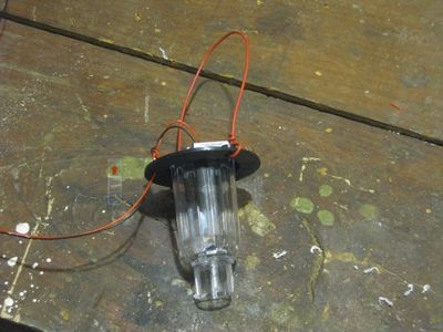

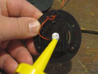

Step 5: Mount the LED in the Case
Use some electrical tape or heat-shrink to insulate the wires where you spliced them. I used that Liquid Electrical Tape stuff, then I covered it with the original cloth insulators that were on the LED to start with.
Insert the LED through the hole, so that it is positioned exactly where it was when you bought the walkway light.
Shoot in a blob of silicone caulk behind the LED for weatherproofing.
Set this assembly aside to dry and cure for the rest of the day.

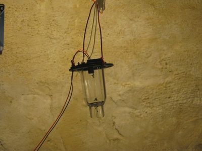

Step 6: Final Assembly

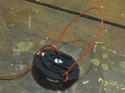

Get a piece of stiff wire, at least 15cm long. Secure one end to the LED case's 12-o'clock hole, and secure the other end to the 6-o'clock hole. The ornament hangs from the tree with this wire.
Secure the clear plastic shell so that it again covers the LED.
The entire system is now complete and ready for hanging! If you do not like the way that the bare wires are sticking out of the top, you can add your own ornamental decorations to it, or dangle a ribbon or bow from the bottom or something. As it is now, the ornament will glow white. It's possible to use a different colored LED in this circuit, but a different LED may use more or less power than the original, so there's a chance it will discharge more quickly (especially if you are using a super-bright LED, or an LED that changes colors by itself). You could also try wrapping the ornament in different colors of cellophane to get different color effects.
For now, for the sake of simplicity and cost-savings, I will use the same LEDs that came with the system and just enjoy white-light Christmas ornaments.

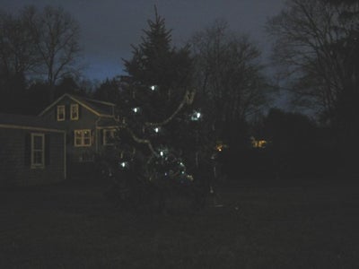

This is the current system as it stands, with 6 walkway light ornaments. Actually, one or two of them are not working because I tried to redo some cold-soldered joints on the circuit boards and may have damaged them instead, so this image is slightly photoshopped.
If you can, use wires that have dark-colored insulation (get black telephone wire). That beige wire I used is very difficult to hide in the tree during the daytime - that's the reason that Christmas tree lighs have dark-green wire connecting them up.
