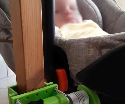

- Connect all 3D printed parts with screws, couplers, etc (more information in TwinTeeth).
- Connect the dispenser to the carriage of your CNC machine (in the case of FABtotum, with HDB support, the aluminium plate and the PCB of HDB kit with supplied screws).
- Add the electronics on the printed base and connect them with cables (more information in HDB of FABtotum), as shown in this page. Basic idea is to connect arduino pins 2,3,4,5 with IN1, IN2, IN3, IN4 of ULN2003 board. Power supply needed for all electronics is 5V.
