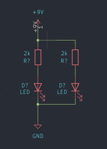

Before we begin soldering, we need to have a design first.
For this tutorial, I have created a simple circuit diagram consisting of two LEDs in series with the appropriate resistors which in turn are in parallel with a 9v battery.
In case you're curious about why we need resistors, they prevent the diodes from drawing an unrestricted amount of current from the battery. These resistors act as current limiters, which puts a cap on how much current a LED may draw. The specific value of these resistors varies based on the voltage and the LED's current rating, and we can determine this through Ohm's Law
Voltage = Current * Resistance
We are using a 9v battery, and a typical LED is rated for ~15mA. If we plug those values into the formula and solve for the resistance, we can determine the minimum value needed for our resistors.
9V = .015A * R
R = 9V / 0.015A
R = 600 Ohm
2kOhm resistors are a bit excessive for LEDs powered by a 9v battery, but it allows us a good margin of error while still allowing them to function properly (they were also the only resistors I had that were above 600 Ohms).
