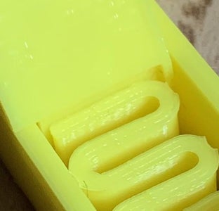

Once parts for the chosen design have been printed and cleaned, assembly is very simple.
Push the moving part of the clamp into the slot from the top and slide it up to the fixed part of the clamp.
Compress the spring and push it into the gap behind the moving part. There are recesses in both the clamp and the frame to secure it.
Step 3: Using
To operate, press the moving clamp inwards against the spring and insert the item to be held in between the jaws then release the moving clamp.
To release an item, press the moving clamp again and remove the item before releasing it.
