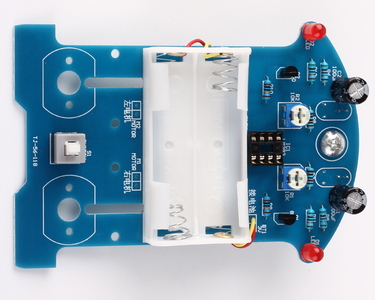

Step 3: Installation Steps_Install Circuit
1.1 Install metal film resistor,DIP-8P IC socket,Self-Locking switch,Potentiometer,S8550,Electrolytic capacitor,5mm Red LED on PCB according to mark on PCB.
1.1.1 Pay attention to the direction of IC Socket.
1.1.2 In addition to facilitate debugging, don’t install IC LM393 temporarily .
1.2 Install Mecanum wheel
1.2.1 PCB placed in front.The support bolts of the caster are inserted into the hole, tighten the nuts screwed into the caster, and finally fit the caster and tighten.
1.3 Install photoresistor and white LED on PCB reverse.But please make sure the distance is about 5mm between top of mecanum wheel(top of screw cap top) and photoresistor/LED.
1.4 Install battery case.
1.5 Test.
1.5.1 Install 2pcs AA battery.
1.5.2 Press on switch. If 2pcs white LED ON,the installation is successful.If LED off,please check the welding.Pay attention to the direction of LED and other component and check pseudo Soldering.

Step 5: Completed Soldering and Test the Car
3.1 Power on.Check S8550 or 10ohm resistor if motor don’t move.
3.2 Install LM393(Pay attention to the direction of IC).
