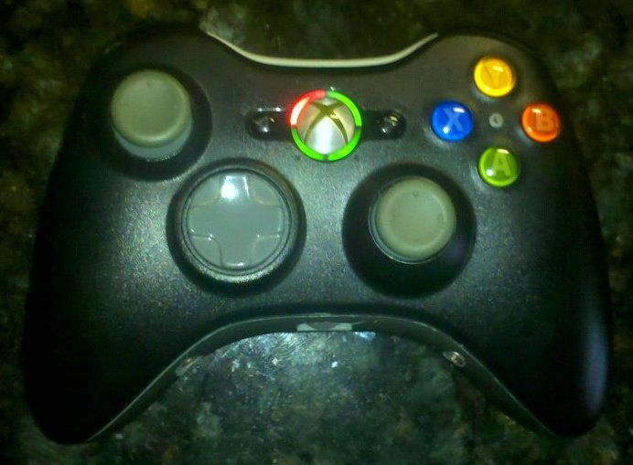

This technique can be used for both normal and rechargeable batteries, so if you need to replace some rechargeable batteries in battery packs like the one from the Xbox 360 you can now do it. I also used it when making this instructable https://www.instructables.com/id/Copper-plating-made-easy/.
