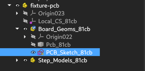

  3. After the import is finished, locate the PCB_Sketch_xxx file on the Model panel in the FreeCad, like shown in the 2nd pic.
  4. Double click to edit it, and make the part fixture outline. mine shown in the 3rd pic.

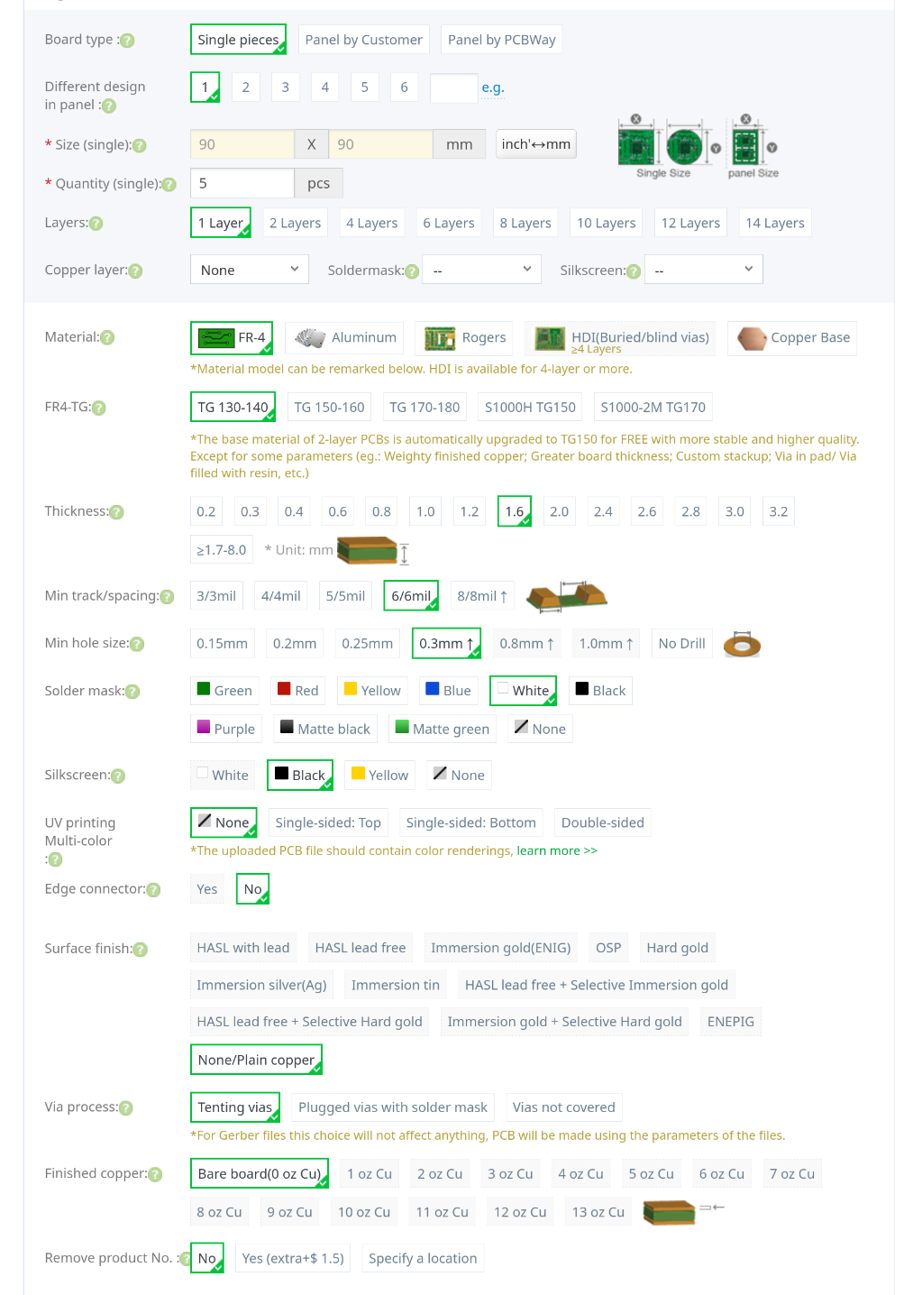

Now export the gerber file and order the PCB as usally from PCB fab. I used PCBWay, you can use me promotional link to order yours.
Remember to use no coper layer as shown in the pic, PCBWay will look into the file and give you a quote, easy.
