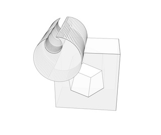

Step 2: 3D Printing Parts
3D print the following parts, using the STL files attached
Battery Base holder
Pencil T holder - you'll need 2
Alligator Clip holder - you'll need 2

Step 3: Preparing the Base
Take about 6 AA used batteries and tape 2 batteries to make 3 sets.Now tape two sets together to form a 4 battery base and then add another set on top.
Apply more tape to the top set if the batteries don't fit in snug in the battery holder, ensure that the batteries should not fall off if you rotate the base..
In addition you can use super glue to secure the batteries to the holder base.

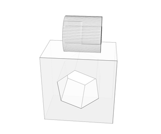

Step 4: Building the Verticals for the Hands
Cut the pencils after deciding the approximate height of the helping hand.
Tape the pencil, so that it fits snug in the base stand(the hexagon where the pencil fits in is slightly larger to accommodate all type of HB pencil) , you may have take the tape 2-4 times around the pencil, based on the thickness of your pencils
Tip: Secure only one of the pencils to the base using super glue, only if you are happy with the height.
Add the horizontal T shaped part to the top of pencil, apply a couple of circles of tape for a snug fit, DO NOT glue this end, as you will need move this around based on the size of your PCB or the area you need to solder..

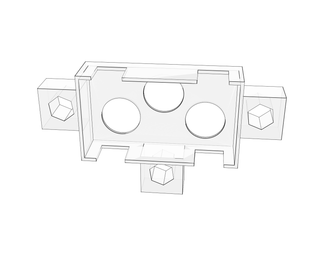

Step 5: Building the Horizantal Part of the Hand
Get the T-shaped 3D printed parts off the vertical pencils to attach the other parts which will form the vertical part of the hand
Cut the pencil, if you have long pencil a good idea is to cut in half.
Apply tape to the pencil so that the 3D printed T shape fits snug.
Attach the alligator clips to 3D printed part using super glue , and leave it for about 5-7 mins to dry..You may need a plier to change the shape of the alligator clip end so that it fit in the circular cut of the 3D printed part..
Apply tape to the other end of the pencil so that it fits in nice and snug with the alligator clip 3D printed part..
Attach the horizantal hands to the vertical hands
