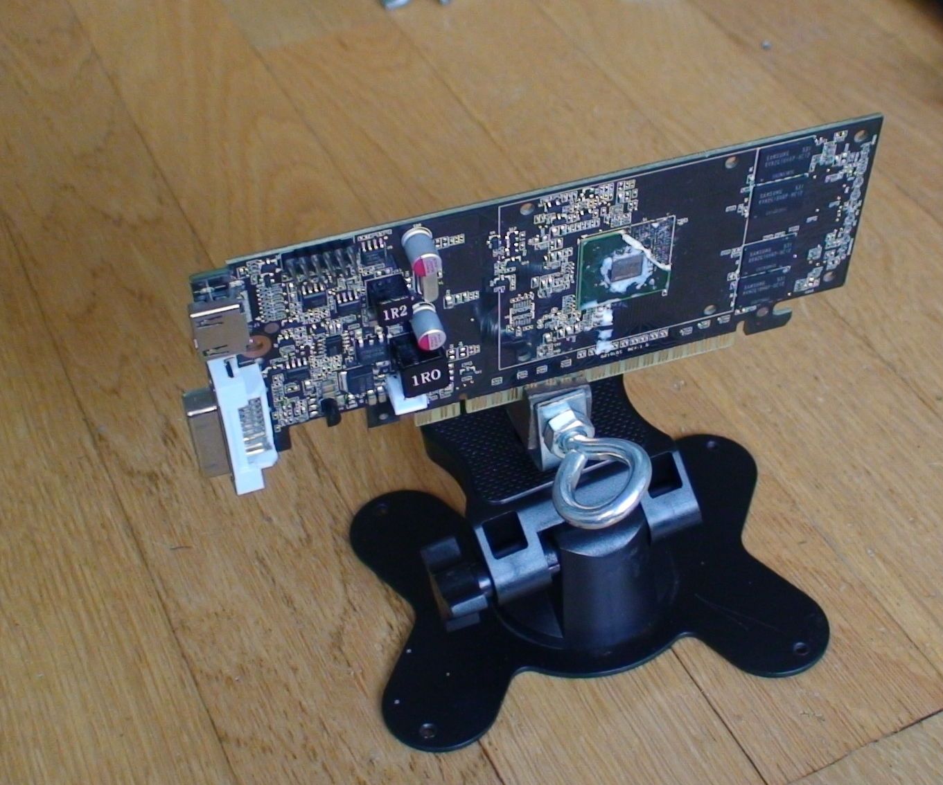

You will need a base. I used a piece of steel from a broken computer monitor because it has two pre drilled screw holes. You can also use a wooden base. You also need two short sections of solid copper wire. You also need two small binder clips.

Strip a short section on one end of the copper wire. Bend it into a loop. Repeat for the other section of wire. Use this loop to screw your wire to the base.

Pass the wire through both ends of your binder clip, then bend the wire around to secure the clip.
