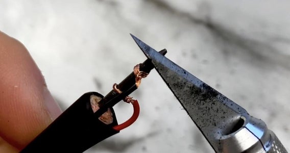

Get a HB pencil and use a blade to cut a groove all the way around the wood, about an inch from the top.
Use this to carve away the pencil upwards, using the blade (see video) until all that's left is the graphite (see images).
Step 3: Wire Grooves
On the exposed graphite, use a blade to (gently) carve two grooves all the way around, about half an inch apart.
These are where the wires are going to wrap around.

Step 5: Connecting the Wires
Wrap one of the wires (either one) around one of the grooves of the graphite (from Step 3) and pinch and twist the pencil around so there is a firm connection between the wire and the graphite.
Do the same with the other wire.
Use tape or heat shrink tubing to attach the wires to the side of the pencil.
Using a blade, sharpen the tip (gently - if the tip snaps, you're back to square one!)
