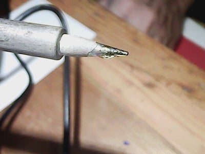

Keep oxygen away from the tip. You can do this by keeping fresh solder on the tip when not in use. The photos show (in order):
- Tip with old solder and poor coverage
- Freshly cleaned tip - ready for use
- Newly applied solder - tip is not ready for standby
- Keep your heat low; turn off when not being actively used.
- After each actual use, coat the tip with fresh solder before putting back into its holder.
