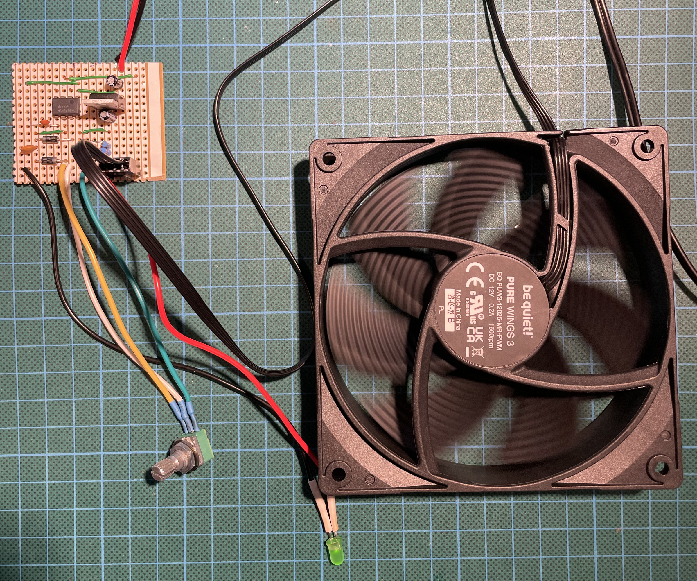

When our electronics projects need to get input or provide feedback to the user, we usually need to use some kind of panel hardware.
For example, toggle switches, potentiometers or input and output jacks. Often these aren't available in panel mount versions with proper solder tags, instead we have to use devices which are meant to be soldered to a PCB. Sometimes the PCB mount versions are also cheaper.
The good news is it is very possible to solder wires onto PCB mount hardware, and in this Instructable I will show you how I do it.

Cut the wires to the required length and strip approx. 5mm of insulation off the end to be attached to the device. Strip the other end as your application dictates. If you're using stranded wire, twist the ends so they are neat.
Hold the wires in your helping hands, tin the wires by using the soldering iron to apply a small amount of solder to the stripped ends. You don't need a lot of solder here, just enough to coat the end and keep it all held together (if stranded)
Step 2: Solder to the Device
Clean the pins using isopropyl alcohol (IPA) on a Q-Tip or similar then give the pins on the device a good wipe with flux. The flux isn't essential, but it will make the job simpler. If you aren't using flux, at least make sure the pins are free of grease or other contaminants which will affect the solder.
Support the device, a rotary encoder in this case, in your helping hands or other clamping system
Place the tinned end of the wire against the device pin then apply heat using the soldering iron until the solder melts and reflows.
Hold this for a couple of seconds to ensure the pin is well heated and will form a good joint. Remove the soldering iron and hold the wire until the solder has solidified.
Repeat for each pin.
