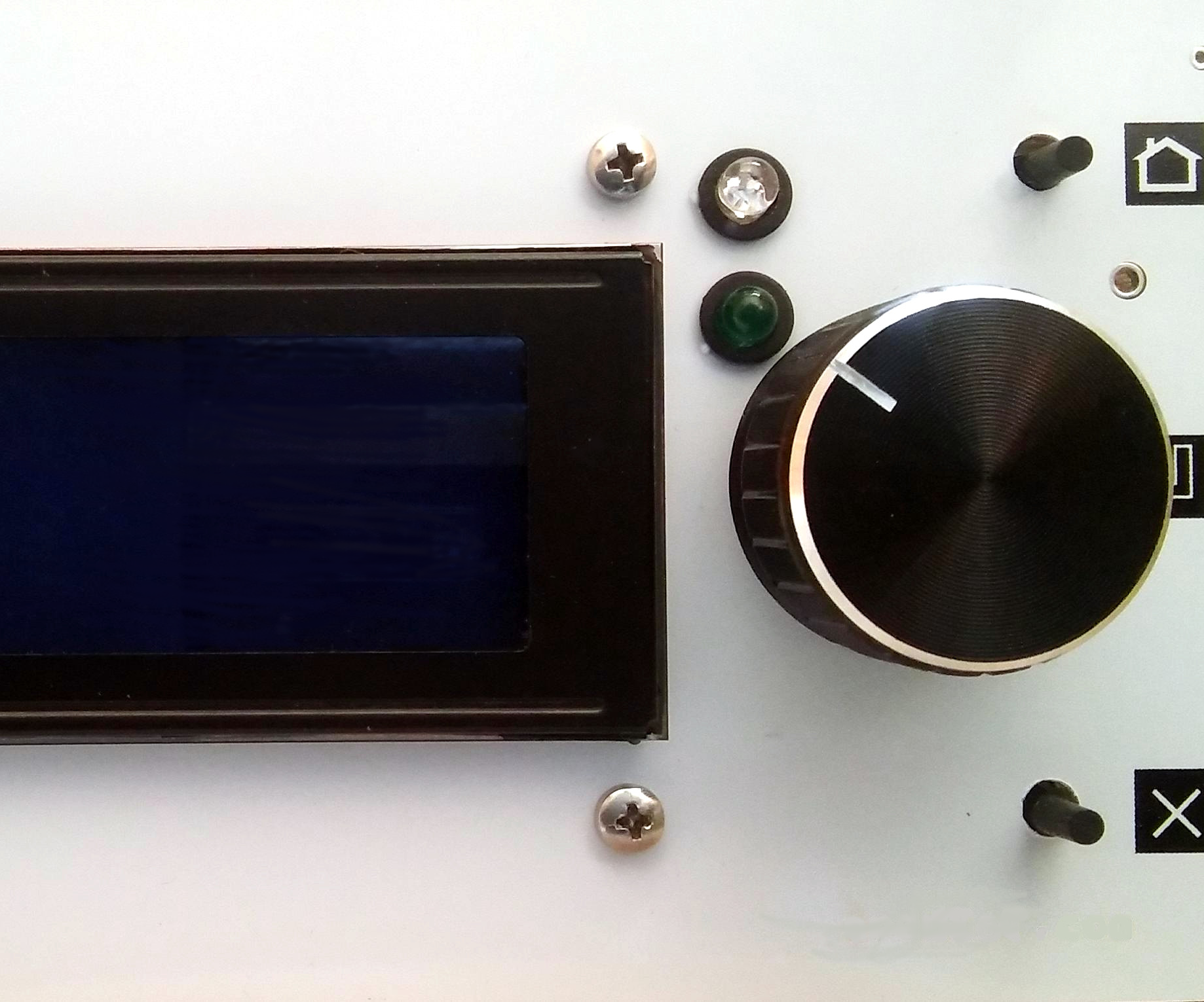

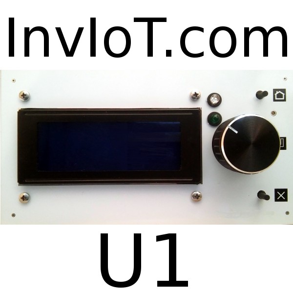

I am using the InvIoT U1 board to build a soldering station. There is a sensor with a wire connecting to the base of the soldering station with the InvIoT U1. That way I sense that the soldering iron is on the base, and if is sitting there for some time to drop the temperature.
Also if you haven’t used the soldering iron for some time (default 10min), it will shut the soldering iron down.
On the display there is a time clock. Everything is configurable through a menu.
