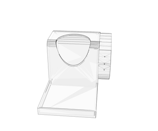

This is my first very instructables, for this instructables you will need a 3D printer and this files and other objects.
Step 1: Light - Assembly and Soldering
For the light you will print:
  • Solder Station - Luce-1.stl
  • Solder Station - Top Luce-1.STL
the materials:
  • some screws
  • wires
  • switch
  • a led or a bulb led
  • 2 copper plates
  • battery 3 cells AG10
Assembly
  1. soldering wires at the copper plates, bulb led and switch.
  2. insert into the slots the copper plates.
Step 2: Finally Assembly All Pieces and Attach All Objects
  1. put light with a glue into slot of soldering station.
  2. put the sponge and the cheap stainless steel pad for cleaning your solder.
  3. Solder Station is finished :)
