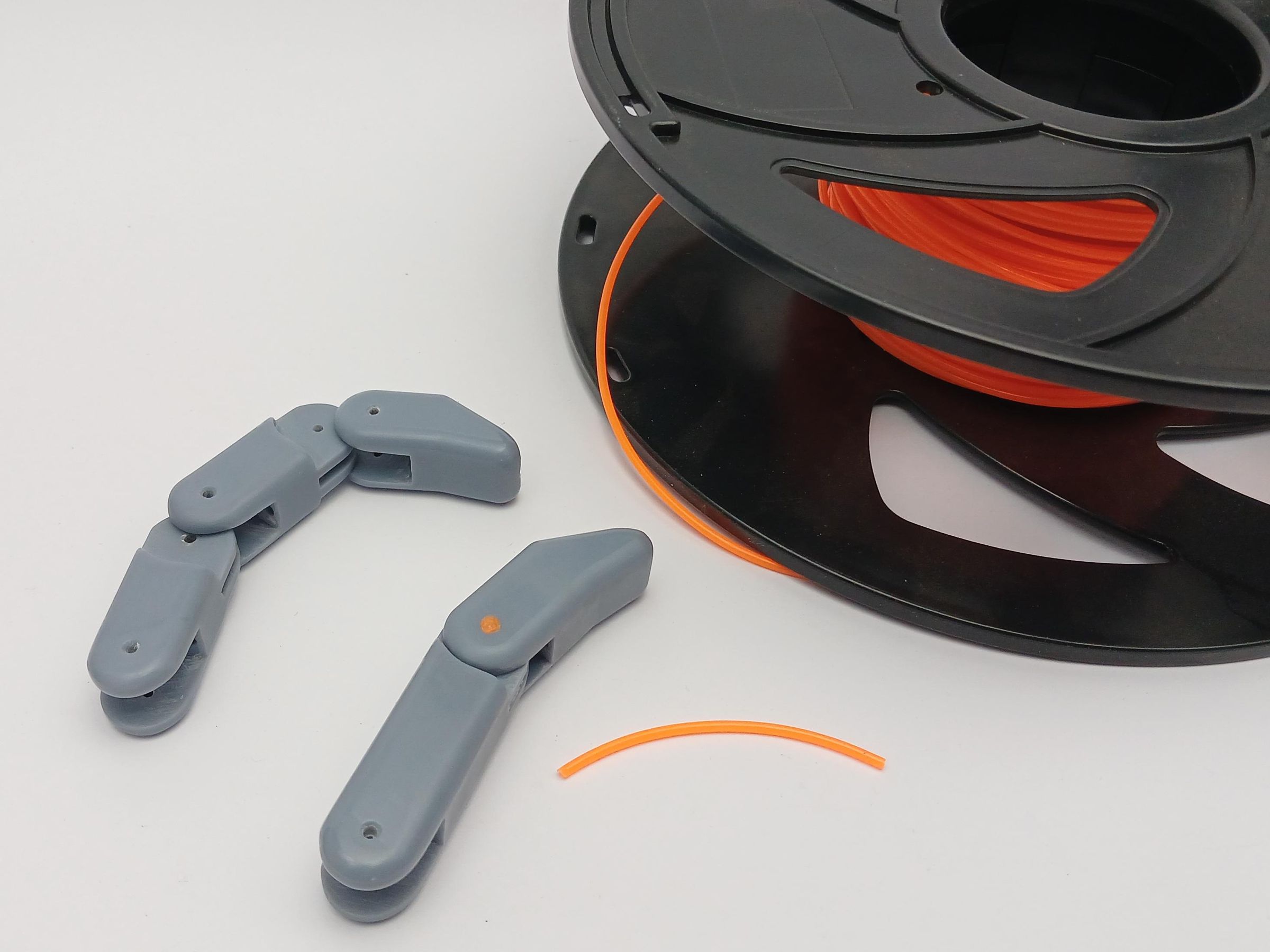

The articulation of the joints are simply based around standard 1.75mm PLA filament as it is slippery enough to not bind up the joints and super easy to work with. For the motion system there is simply two holes running down both digits one for the pull/closure nitinol wire and the other for the spring/open action.

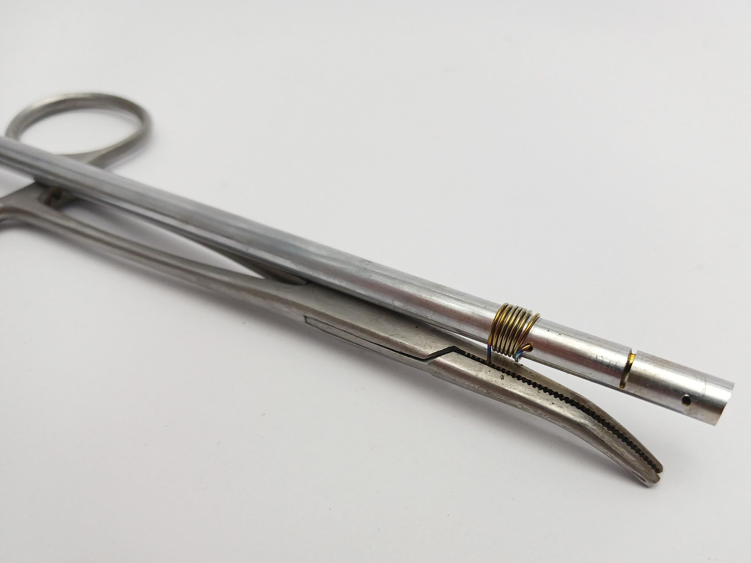

Step 4: Making a Nitinol Spring:
The whole motion system relies on a spring that will pulled apart by an external force and will contract when a current/heat is applied, now this step doesn't look that complicated but it took quite a few tries to get something that actually reassemble a spring.
To form a spring you simply need to wrap a wire around a cylinder right...the problem is with nitinol no matter how tight you bend it it will just spring back to its original shape...with force!
To form it it needs to be moulded around the cylinder and heated, but this also has some complications.
Heat it too much and it loses its amazing properties and as soon as you start heating it the force that it wants to return to its original shape with multiplies, so you need to have a way to keep it clamped onto the cylinder, heat it evenly and be able to quench it in water very quickly.

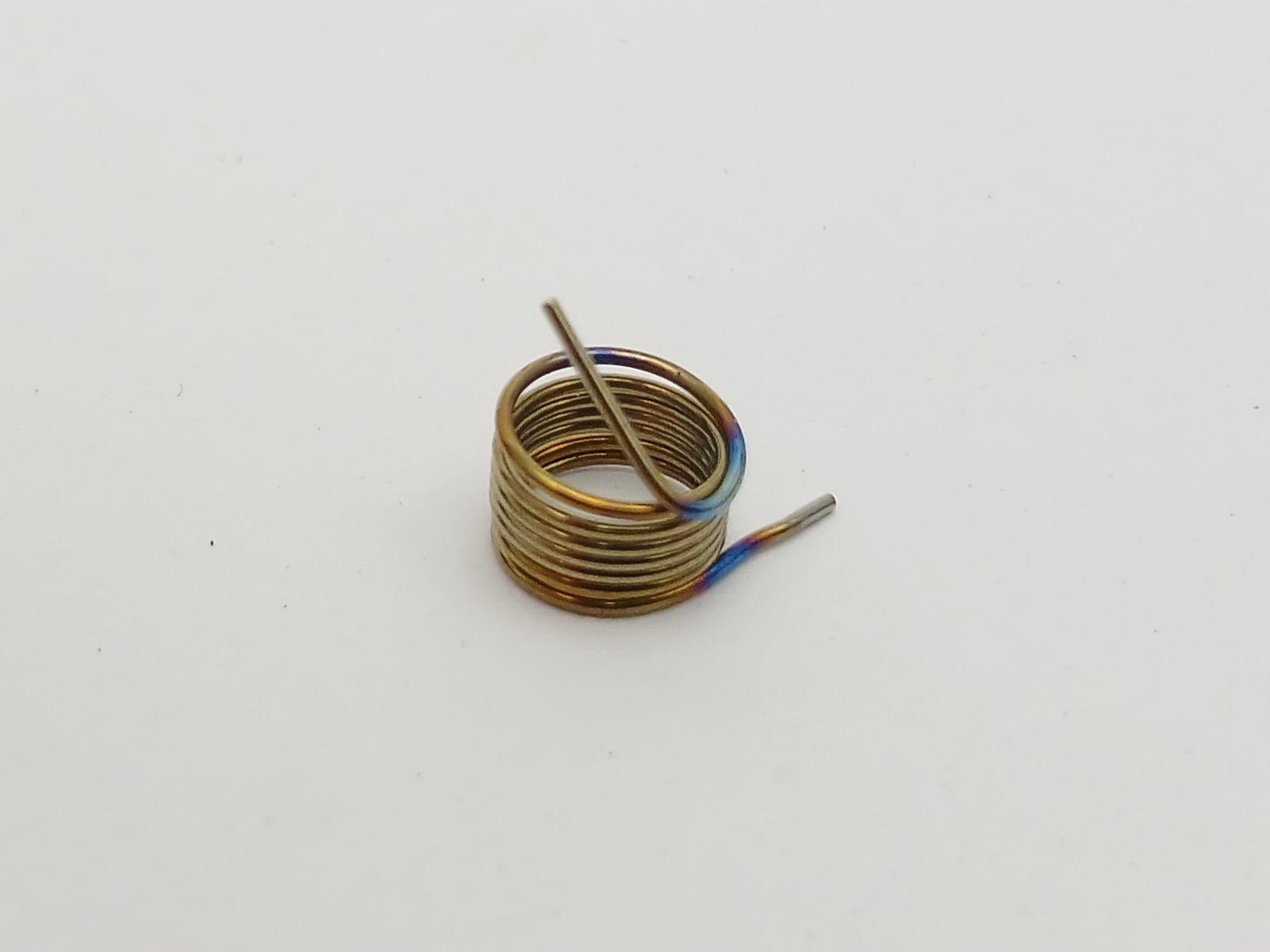

After a few tries I found the best way was to first drill a 1mm hole into a 5mm brass tube, this will hold onto the start of the nitinol wire and the brass tube will control the heating process.
Next I used a pair of self locking pliers to clamp onto the other end of the nitinol wire, I then tightly wound the wire around the tube to form a tight coil.
Holding the end of the brass tube tightly against the handle of the pliers we need to heat up the coil with a butane torch until the shiny silver wire turns golden (being titanium the wire will go from silver to gold,blue and then purple) as you bring the flame onto the coil you will immediately feel quite a strong force applied to the brass tube as it tries to unwind then as soon as it turns golden the force will stop and your coil would have formed, you will need to immediately quench the coil in water as soon as it changes color.
With it cooled you can now remove your coil and if everything went correctly you can pull it as much as you want and it will always return to its original coil.

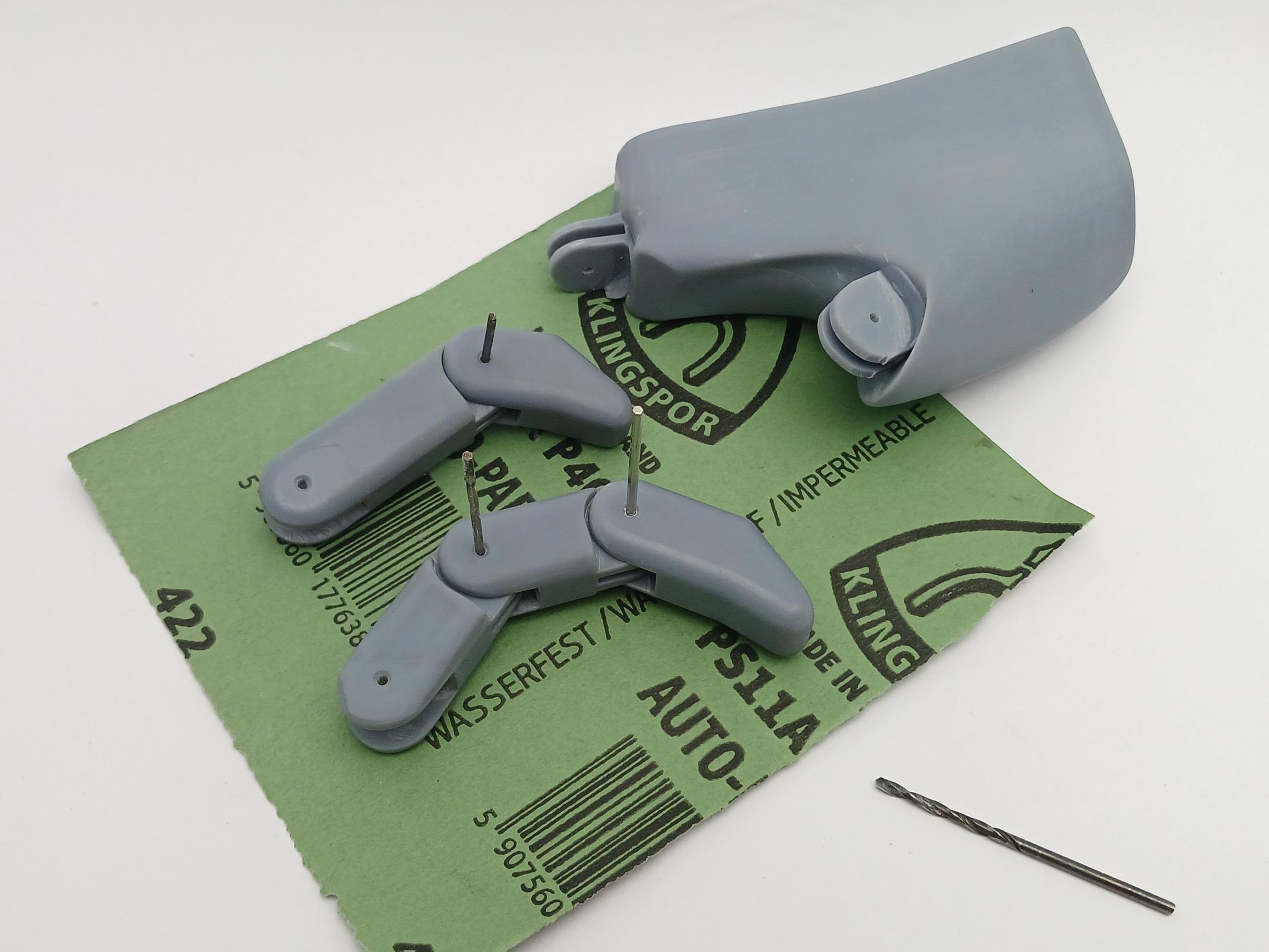

Step 5: Refining the Test Platform Joints:
As with any motion system we need joints that slide smoothly and without binding and excessive friction.
As 3D printing always has some imperfections and distortion I used some wetted 400 grit sanding paper to sand each joint until I got smooth motion.
An easy way to spot problematic areas with resin prints is to temporarily assemble your joints (I used a drill bit as the hinge) and move it through its motions this will mark up the problematic areas which will be white and chalky.
Afterwards I used a 2mm drill bit and cleaned up all of the hinging holes, 2mm will give enough room for the filament piece but not big enough to cause binding.

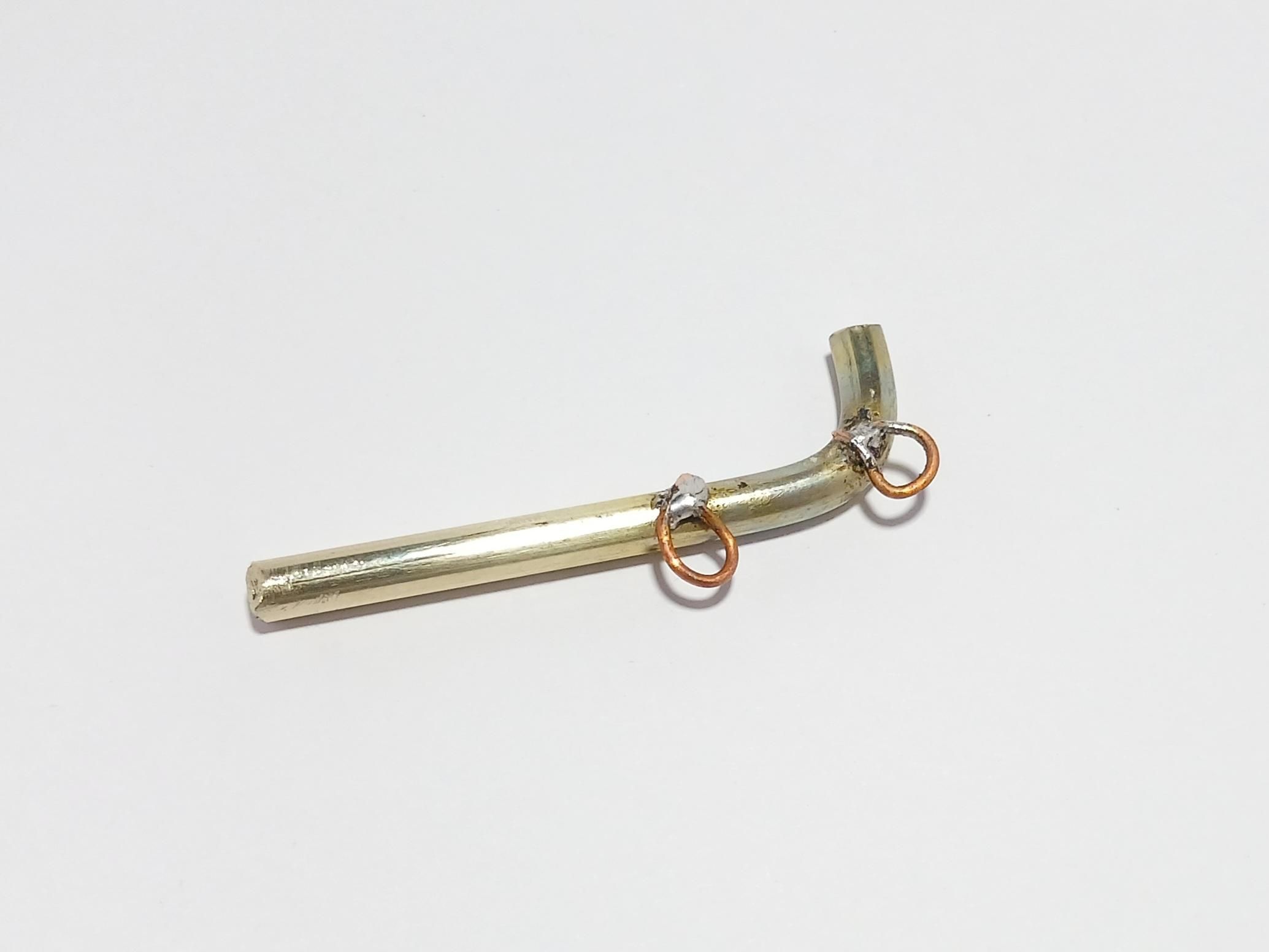

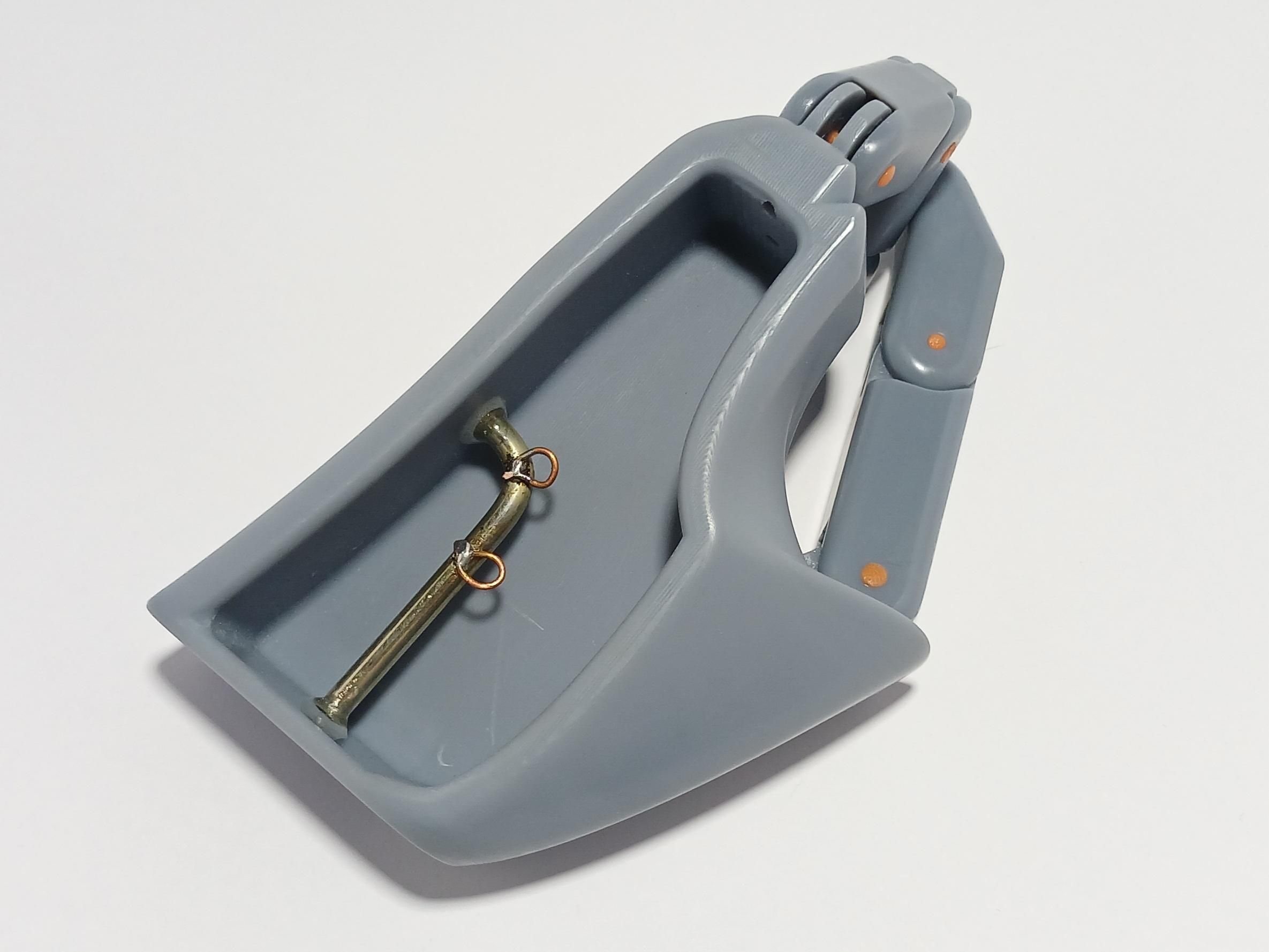

I decided that using a single ground/negative buss bar that the ends of the nitinol springs can clip onto will simplify assembly and the electrical setup.
There are two 4mm holes on the inside of the printed palm that I made to fit a 4mm brass rod in, I simply bent the the rod into an L and cut it down to size.
Onto the brass rod I soldered on some copper wire that was bent into circle to clip the nitinol springs onto.

First we need to assemble the digits, I started by applying some light Lithium grease to each of the joints contact points before sliding them into each other. The hinge is made by simple pushing through a piece of PLA filament and then heat up the end of the filament with a lighter until it starts to soften and push it flat against the resin part, next cut off the excess filament on the opposite side and heat it up and press it flat to create a collar that holds the filament piece in place.

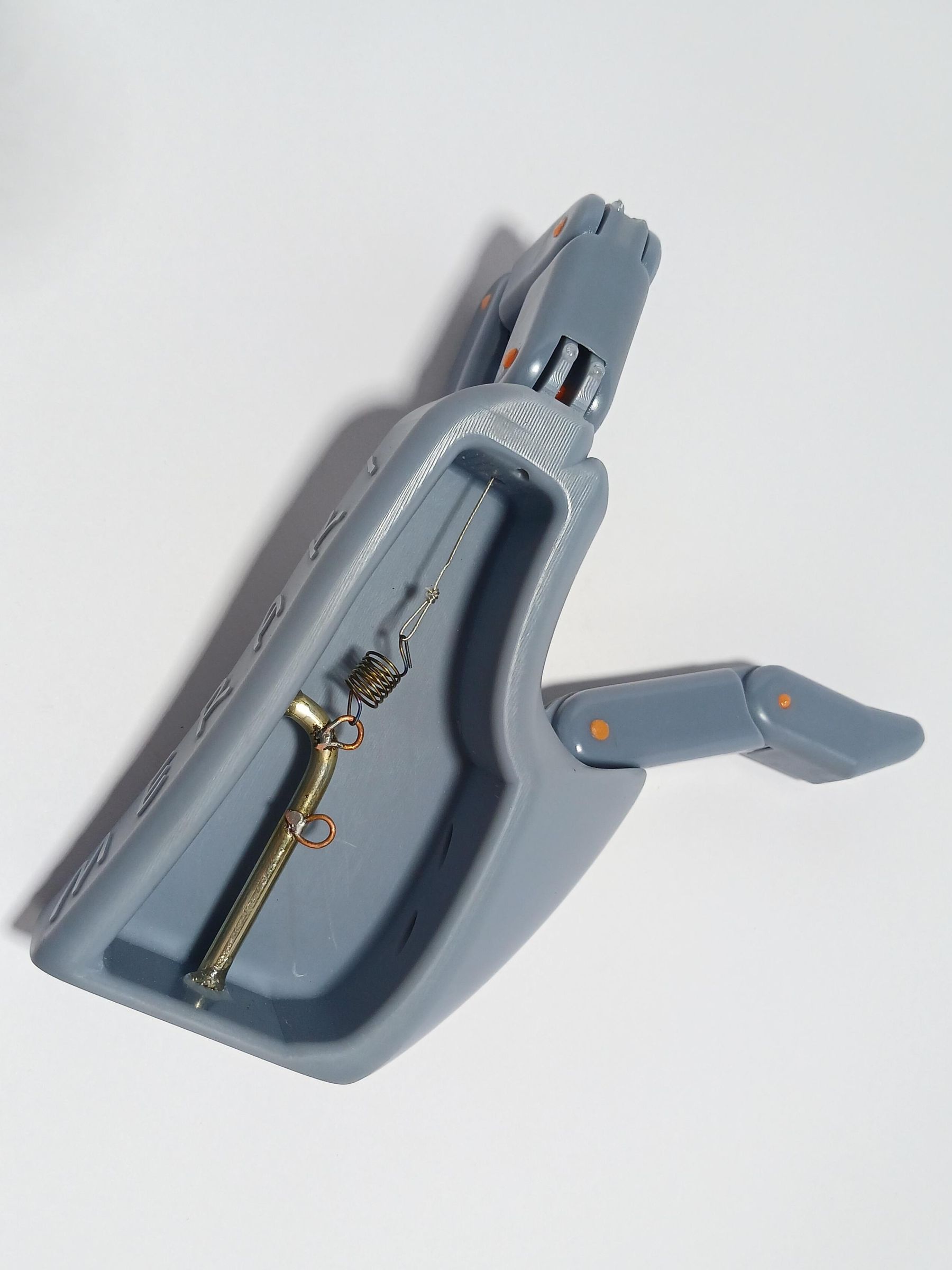

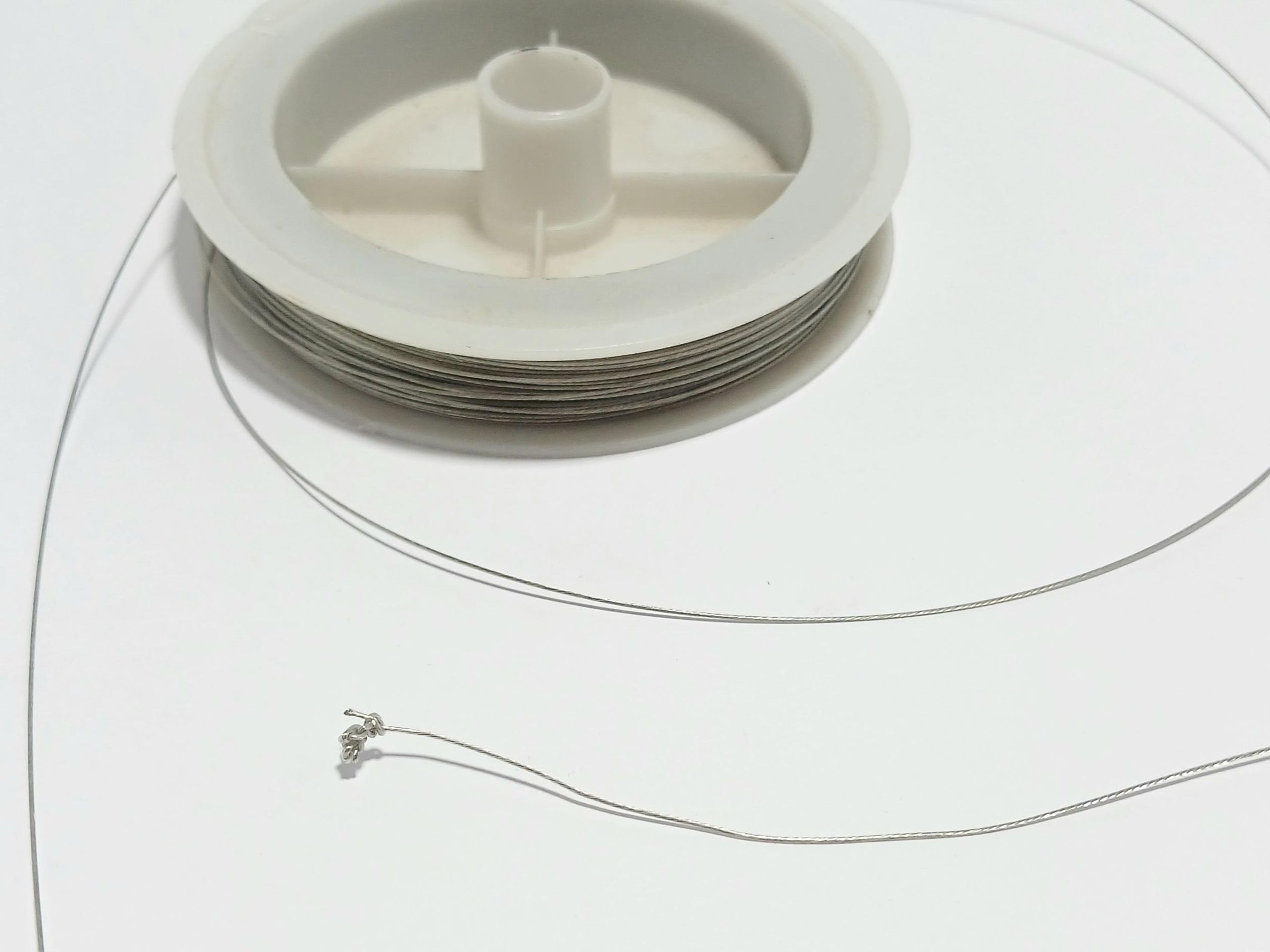

For cabling I use jewlers 0.45mm tiger tail wire which is a twisted stainless wire encased in nylon giving a stretch free slippery cable perfect for robotics. The cable is simply knotted on the finger tip side to avoid it slipping down the hole and on the palm side I tied a loop that can clip onto the nitinol spring.
Attach the nitinol spring to the end of the loop in the tiger tail and then the other end onto the bus bar and test out the motion.
