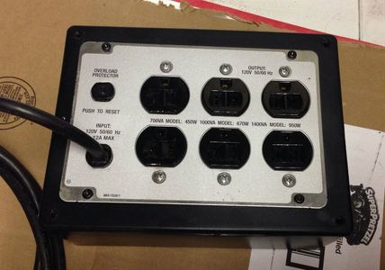

Step 2: Second Generation
I salvaged an AC panel from an old UPS and got a new enclosure from Radio Shack. That is the only part that wasn't recycled. I used a scroll saw to cut out the center of the lid to accept the UPS panel.
