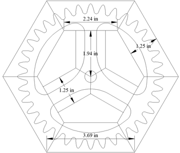

Step 1: Draw the Gear
The first step is to draw an involute gear with a 20-degree pressure angle. The gear will be cut on a CNC router so use a tooth size that is large enough for your router bit. I use gear profiles generated using Gearotic with a 45% tooth width for extra clearance. Extra modifications are done in CAD. The tips are extended to round them over and valleys are cut deeper so the router bit can cut them easily. The spokes are also optimized for this process.
Draw three spokes with rounded corners that will be smoothed later using a 1/8" roundover bit. The inside fillets should be large enough for a small spindle sander and the bearing on the roundover bit. The clamping method used to make these gears works best with three straight spokes.
Draw a hexagon around the entire gear with 0.15" or more clearance outside the gear teeth. Draw another inner hexagon inside the spokes. Add the remaining lines to define the sizes of the glued-up gear blank. There should be at least 0.15" clearance inside and outside all cut lines. Add dimensions to define the sizes of the wood segments to be cut.
Repeat the CAD process for different size gears. A 32-tooth gear will have a different size blank than a 36-tooth gear.

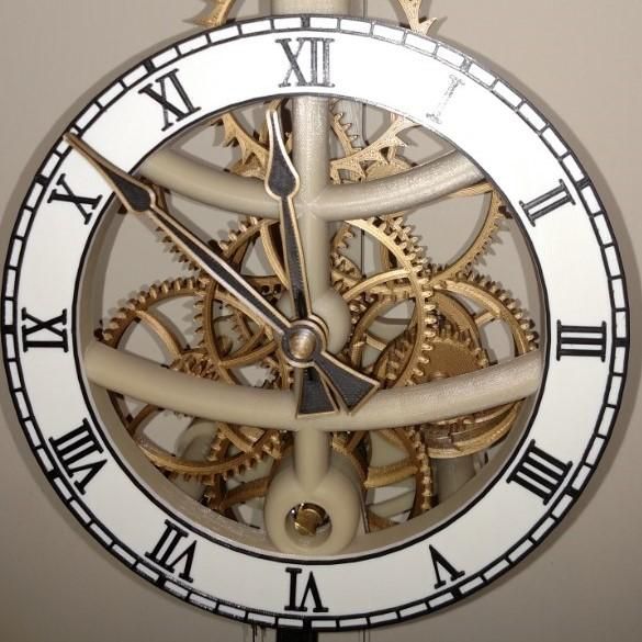

This is the new gear placed over the top of my tiny wooden gear clock (actually it is bamboo, but it looks and behaves like wood). The new gear is completely stable. Expansion from humidity will make the spokes wider, but not longer. The rim will also get slightly wider, but not longer so the shape should not change. The gear was cut a few years ago and is still perfectly flat and stable.
I got side-tracked with a bunch of 3D printed clocks and never finished a large clock using this gear cutting method. Hopefully, it is coming soon and will be the topic of an upcoming Instructable.
