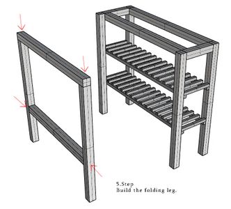

Step 3: Building Body
Step 4: Attaching Shelves
Step 5: Building Folding Leg
Step 6: Attaching Folding Leg
Step 7: Cutting Top Part and Attaching
