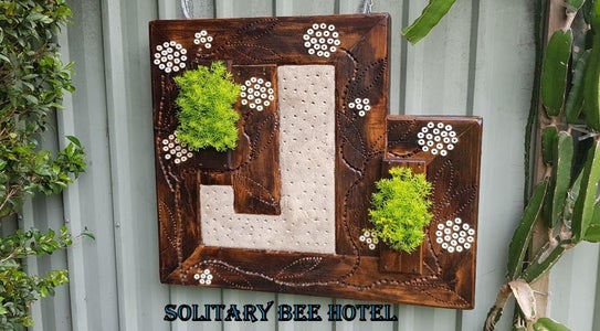

I didn't just want to just drill holes at random all over the place, but rather come up with a pattern to add some artistic value to my piece.
Being an outside garden ornament, what better to than to come up with the pattern of a vine bearing flowers. I sketched up a few designs on the timber in pencil before settling on one which I thought was best suited to my liking. Because bees come in several sizes, I decided the holes would need to be of varying diameters to cater for as many species that would hopefully be attracted to my hotel.
Step 3: The Flowers.
I already had a bottle of 20mm ceramic noodles that were used as filter medium for my aquarium. These would be ideal for representing the petal of each flower. They already had a 7mm hole in the centre as a bonus.
I chose to countersink each noodle for sturdiness rather than just glue them in place on the surface.
Because i needed to make several flowers, i created a template out of scrap Perspex to drill just the pilot hole where each noodle would sit.
I found the timber was rather prone to splintering with my spade bit, so I used a piece of scrap timber (as shown) to sit over each hole prior to drilling out each petal. This also served as a depth stopper so all the holes would be of uniform depth.
With that complete, i drilled the centre of each hole made by the spade bit to further extend the nesting hole into the timber.
Step 4: The Leaves.
As with the flowers, I created another Perspex template for the leaves. After drilling the first hole, I inserted a nail through that hole to hold the Perspex in place, then swung the leaf around until I was happy with the orientation then proceeded to drill out the remaining holes to complete the leaf.
Step 5: The Vine
For the stems of the vine, I drilled 10mm holes along the marked outline, spacing them about 15mm apart, then for definition, i joined them all up with a router.
Step 6: Weather Proofing.
After drilling umpteen holes, it was time to give it all a light sand to clean up my work.
Although this timber is relatively resistant to wood rot, I applied a few coats of exterior varnish for further protection.
Step 7: Adding the Sand Mixture.
Before adding the sand medium, i screwed some marine ply at the back of the frame where the sand will sit.
Sand on its own, is not suitable for the nesting bees and needs to be strengthened with clay to help with binding and prevent cave ins when the bees are tunnelling out their nests.
I already had the sand and clay on my property so went with a 1:5 mixture of clay to sand.
After tamping it down and smoothing it off with a trowel, I proceeded to poke holes with a pencil at random into the moist mixture for nesting. I didn't poke too deep, just about 5mm as a starting point for each burrow. This would allow each bee to do the remaining work in digging out their rest. It is obviously much easier to do this step while the mixture is still damp.
Once thoroughly dry, I then coated the sand mixture with a couple of coats of clear lacquer to provide a sturdier surface to prevent any erosion that might occur from the weather.
Once the lacquer was dry, I then gently re-drilled the front of each hole, just enough to break the dried lacquer.
Step 8: Ading the Flower Petals
To complete each flower, I secured each ceramic noodle in place with hot glue.
Step 9: Adding Some Greenery.
I also wanted to incorporate some plants into my design in the form of a vertical garden. For this component, I used two plastic juice containers with the side partially removed. I wanted to keep the wet garden soil away from any timber to avoid any dampness and rotting over time. For the growing medium I used a good potting mix with sphagnum moss to retain the soil from falling out the bottom and open side. I then covered the open side of each bottle with a layer of spacnum moss, and then some mesh to retain the plant medium, allowing the plants to grow through. The mesh was held in place with a wooden frame I made up and screwed in place. This enables the bottle to be accessible for replanting at a future time.
I also wanted it all to be fairly maintenance free when it came to watering. It would be fairly difficult to water the plants without disturbing the nesting sites.
I incorporated some plastic tubing with a funnel attached to one end, and mounted the funnels on the roof of my shed to catch the rain. Metal fly screen was added to each funnel to prevent them from becoming blocked with leaves over time. Tubing was attached to the bottom end of each bottle to direct water run off below the wooden frame.
For the plants, I chose sedum as it is relatively hardy and produces flowers occasionally which the bees quite happily visit.
Step 10:
The tenants didn't hesitate to take up residency, and seemed happy with their new homes as they scurried about their business.
