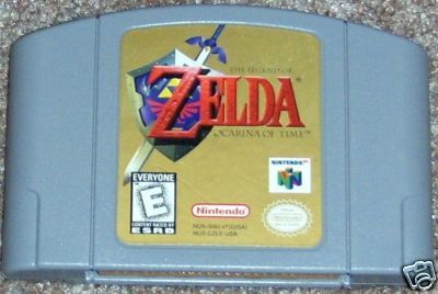

For my birthday, my wonderful girlfriend surprised me with my absolute favorite video game: The Legend of Zelda; Ocarina of Time (OoT).
Without delay, I popped the cartridge into my N64 and played for a good two hours. A little while later, I turned the N64 on again to continue my adventure but my save file was completely erased! I was very disappointed.
With some work I was able to restore the saving functionality to OoT. In this guide, I will show a method that will likely solve your issue if you are experience the same symptoms as I was.
