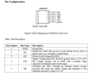

Step 1: XL6019E
I was unable to locate a datasheet for the XH-M411 boost converter module. Upon removing the aluminum passive cooler, I discovered that the module is equipped with an XL-6019F IC. I did not succed to find a solution related to mobile phone charging problems in the datasheet of this boost converter IC.
Step 2: Is the Issue Related to the Voltage Feedback on the 5th Pin of the XL-6019?
One of the key features of this XL6019 is its feedback mechanism, which helps maintain stable output voltage.
The 5th pin of the XL-6019 is specifically used for voltage feedback. This pin is crucial for the proper regulation of the output voltage. It provides a means to sample a portion of the output voltage and feed it back to the IC to compare with an internal reference voltage.

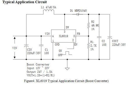

Step 3: Is the Issue Related to Noise in the Output ?
I currently do not have access to an oscilloscope, and as a result, I have not had the opportunity to analyze the output waveform. However, applying the noise reduction solution resolved the cellura phone charginh issue.
Step 4: If the Issue Is Related to High and Low Frequency Noise in the Output, What Steps Can I Take to Address and Resolve It?
Adding capacitors or filters can help address noise-related issues and improve overall circuit performance.
Adding capacitors is a simpler solution, and I prefer this approach for its ease of implementation.

Step 6: Why We Use Large and Small Value Capacitor Together ?
In a regulator circuit, using both large and small capacitors together helps stabilize the output voltage by addressing different frequency ranges of fluctuations. In the context of phone charging issue, the contributions of these two types of capacitors are as follows:
150 µF Capacitor:
This capacitor filters out low-frequency fluctuations, providing a stable and smooth voltage to the phone charging circuit.
Boost modules like the XL6019F can create ripple signals when boosting voltage. The 150 µF capacitor helps smooth these signals and stabilizes the overall output voltage of the module.
0.1 µF Capacitor:
This capacitor filters high-frequency noise. Since the phone charging circuit is highly sensitive, even small and rapid voltage changes can disrupt the charging process.
The 0.1 µF capacitor provides cleaner output voltage by filtering high-frequency signals from the XL6019F’s operating frequency.
