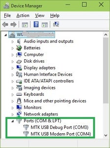

Step 3: Figure Out Which Port Is Which
Go to: Start window > Control Panel > Device Manager > Ports
The port labeled "MTK USB Debug Port" is the port used for uploading code
The port labeled "MTK USB Modem Port" is the port used for testing printing serial messages

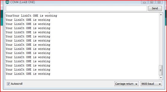

switch ports to the modem port(whatever port that was from step 3), then open the serial window.
you should see "Your LinkIt ONE is working" printed repeatedly in the window.
