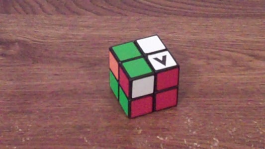

Step 6: How to Solve: Cycles
Now that you know how to solve individual pieces, we will string these together in a cycle to solve the entire cube. After you swap a sticker from your buffer to the solved position, whatever sticker that was in the solved position is now in your buffer. Next, solve that piece using a set-up move, Y-permutation, and undo set-up.
Keep swapping pieces from your buffer to its solved position until you solve all the pieces. Once you solve every piece, the buffer will automatically be solved.
Special Cases:
There are two special cases that might occur when performing a cycle.
Case 1) Your buffer becomes solved before you finish solving all the pieces
This case is represented by the first picture in this step. In this case, simply shoot the buffer piece to any un-solved sticker to begin a new cycle. Keep solving pieces until you need to solve a piece that belongs where you placed your buffer. After that, your new cycle has ended. If you have solved every piece, the cube should be solved. If it is not, start a new cycle.
Case 2) A piece is in its correct position, but it is twisted the wrong way
This case is represented by the second picture in this step. To fix a corner twist, shoot your buffer to any of the three postitions on the twisted corner. Take note of what sticker was in that position. That sticker is now in your buffer, so shoot it to its solved position using set-up, Y-permutation, and undo set-up. The twisted corner should be solved.
Special Cases:

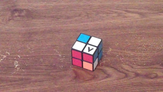

Step 8: Example Solve: Case 1
I will go through some examples on what I would do when memorizing and solving a 2x2 blindfolded. The first example demonstrates what to do when you have Case 1, where your buffer becomes solved in the middle of a cycle. You can follow along by reading the following text and watching the video demonstration below.
Hold your solved cube in your solving orientation and perform the following scramble:
R' U' R2 U' F2 R F2 R F U'
Note: Since the buffer is already in solved position, I start by shooting it to the [L] position.
Memorization:
Letters: L, J, D, F, W, U, V
Audio Loop: LooJ, DooF, WU, Vee
Execution:
L: [R U’ R’ U’ R U R’ F’ R U R’ U’ R' F R]
J: R2 [R U’ R’ U’ R U R’ F’ R U R’ U’ R' F R] R2
D: F R' [R U’ R’ U’ R U R’ F’ R U R’ U’ R' F R] R F'
F: F2 D [R U’ R’ U’ R U R’ F’ R U R’ U’ R' F R] D' F2
W: R2 F [R U’ R’ U’ R U R’ F’ R U R’ U’ R' F R] F' R2
U: F' [R U’ R’ U’ R U R’ F’ R U R’ U’ R' F R] F
V: F' R' [R U’ R’ U’ R U R’ F’ R U R’ U’ R' F R] R F

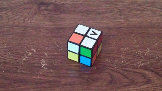

Step 9: Example Solve: Case 2
The second example demonstrates what to do when you have Case 2, where you have a twisted corner. I have provided a video demonstration below.
