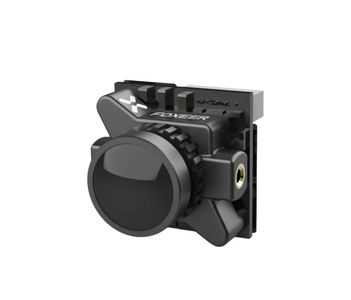

Step 5:
FPV Camera: The Foxeer Razer Micro at $17.99 stands out as an economical yet quality analog FPV camera. Choose this model over others in the Razer series for the best image quality, and ensure compatibility with the Source One frame.
