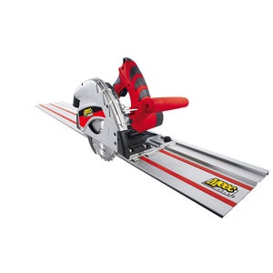

A plunge cut circular saw

Most of the work can be done with handtools but the electric are nice and i really like our plunge cut saw. If i cut a 20x20mm piece i usually use the ryoba saw to save time.
