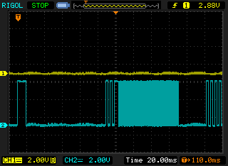

Screenshot 1 shows the first frame (and a part of a repeat frame at the right of the screen). It starts with a long pulse that acts as a wakeup signal. After a pause, the first frame is transmitted.

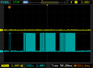

Screenshot 2 shows the wakeup pulse, the first frame, followed by 2 repetitions of the same command. As you can see the repeated frames are different than the first frame and longer. The repeat frames have no wakeup signal.

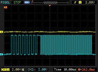

Screenshot 4 zooms in on a repeat frame. It has 7 synchronization pulses and because of that the repeat frame is longer than the first frame. The data, however, is the same.

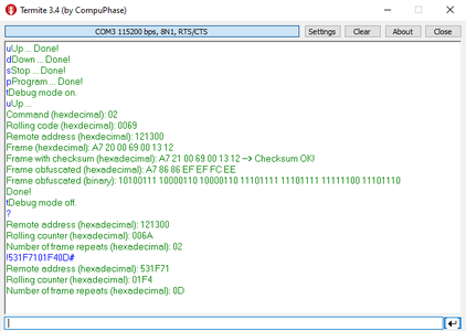

When you reprogrammed the setting you can verify this by typing the command ‘?’ The following screenshot shows some of the responses when a command is given or when the settings are changed as mentioned earlier. I used the terminal emulation program Termite for sending the commands. The blue text is the command being given where the green text is the response of the Somfy USB Remote Control. As can be seen in this example, the settings can be requested and be re-programmed.
