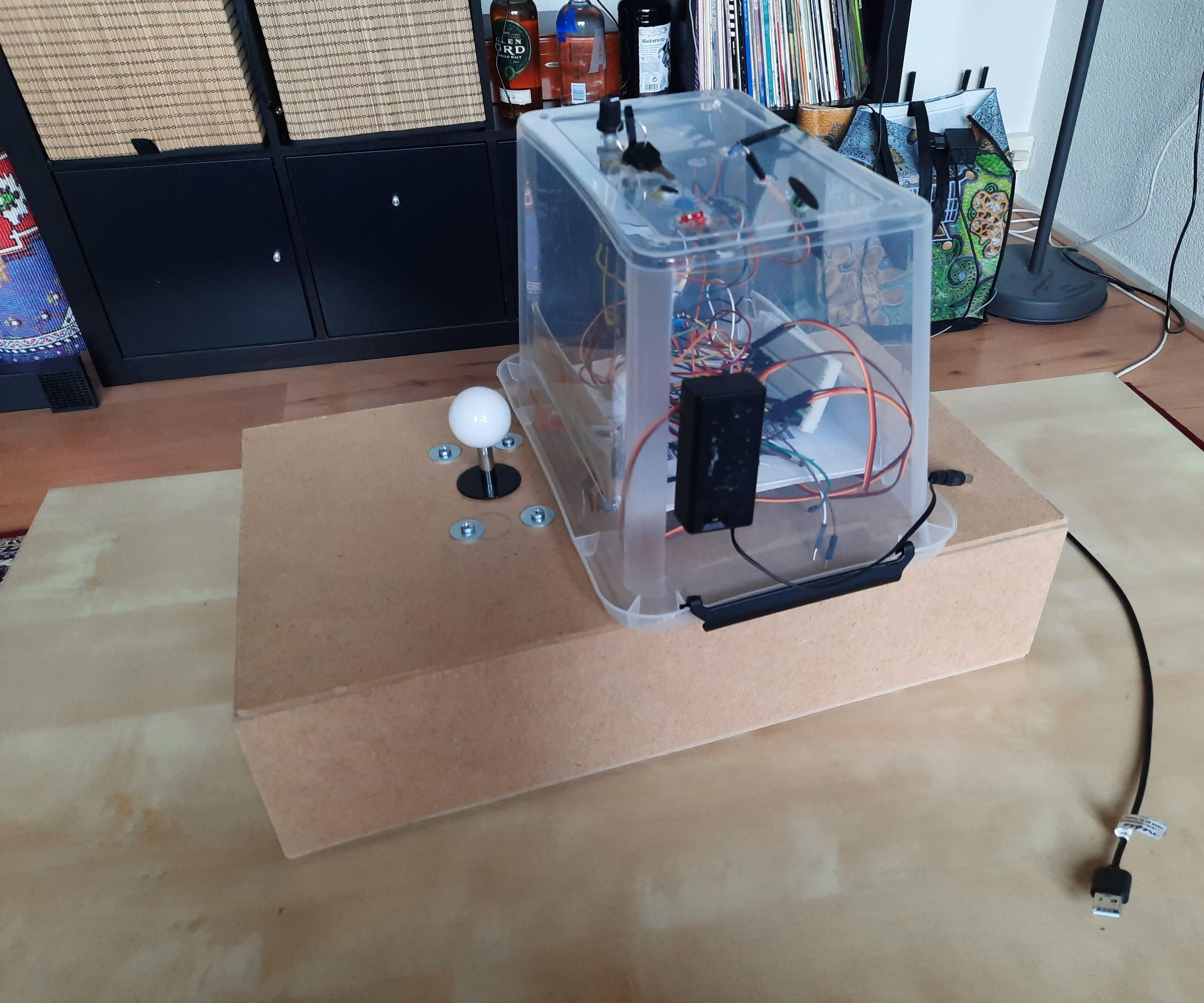

Step 3: Step 3: Modelling the Enclosures
The first file is meant to house the Arduino Uno, battery, and ultrasonic sensor(s). Note that I forgot to add holes for the Arduino's USB connector and power jack in the model, which I later had to drill causing a moderately messy look.
https://www.tinkercad.com/things/iUQgKwrB4Xx-sonar...
The second is meant for the speaker(s)/buzzer(s) and force resistor(s). The small hole is meant for the force resistor's jumper connections to poke through. The larger hole is for the speaker or to hear the buzzer through. A small hole is also added for wires to pass through but I advise you to make it larger just to be sure.
Step 4: Step 4: Soldering
The way I soldered all my parts was kind of a mess the first time around. When I tried again I had a more step by step approach to it, making sure every part and its corresponding wires et cetera were functional. I did this by using a solderless breadboard. I went from buzzer to force resistor to ultrasonic sensor, having all their ground wires and VCCs come together on separate pieces of breadboard. Everything was pinned into the Arduino Uno instead of soldered due to my inexperience and fear of failure.
In the end, I simply glued the pieces together with hot glue to make them whole and ready to be attached to the helmet.
