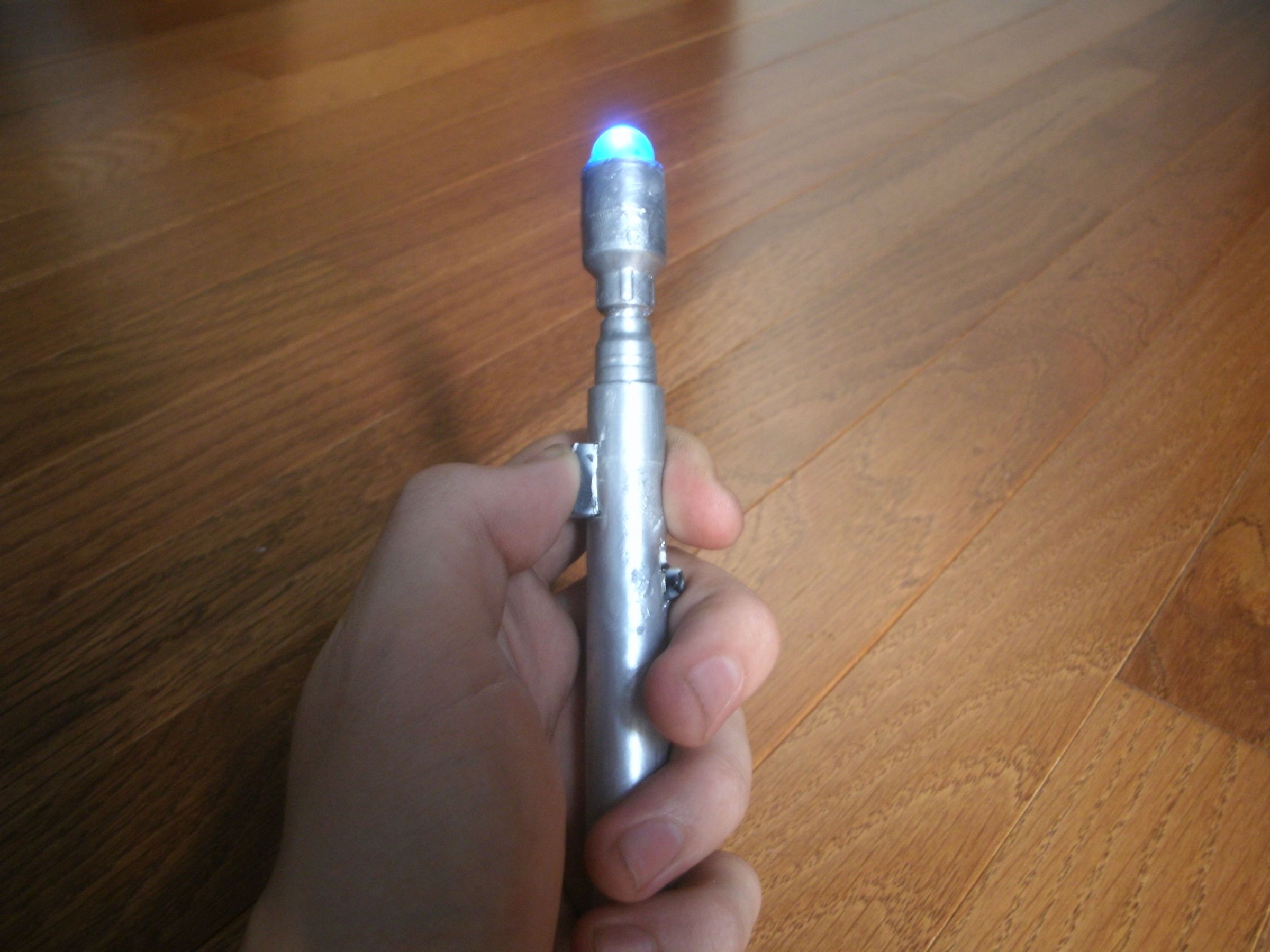

Step 3: The Fancy Electronics
Grab a breadboard and prototype the atair punk console. Go ahead, I'll wait. OK, you'll notice that by playing with the two potentiometers you can make funky sounds.Find a noise that's sonic-y enough for you, and measure those values. You'll need a 1k resistor, and the other two are up to you. Or, you can follow my advice and make them 100k and 51k.
Since space is at a premium here, this will be soldered as compactly as possible. You can see in the pictures that I set the resistors and jumpers towards the inside connecting at a common positive side, and the more bulky capacitors along the outside. The supercaps will connect end-to-end, the negative of one going to the positive of the other, and as a unit (or UNIT) they fit together under the whole 556 assembly. Attach ground on the diagram to the negative side of the series supercaps, but don't do this for the positive side!

You probably noticed that the 556 assembly is a bit larger than the marker. You can sand or file down the inside, and that will help some.
Also, you'll need to attach some wires. Make sure they're small, but not magnet wire size. Just something small.
Attach 2 to the negative terminal. One should be longer than the other; the long one will go up to the LED (make sure it will be long enough even when the pen is extended). The other will go to the charging port. The positive side of the supercaps will have 2 wires as well. One for the charging port, one for the switch. The positive side of the circuit should be attached to the other side of the switch, as well as the positive side of the LED. Thus, 6 wires in all.
Now, to squeeze it in...
Feed the wires in first. Leave them as long as you can, so you can easily guide them to the proper holes without having to deal with pushing the 556 inside. Using a pencil and some small pliers guide the charging port wires to the hole for your mini-usb, the positive terminal and positive side of the circuit to the hole for the switch, and the long wire to ground up into the tip.
Solder on the LED and resistor, and add the wire from the cathode of the LED to the switch from that end as well, guiding it to the switch hole. Again, make sure it is long enough to extend.

Almost there! Cut the wires to a reasonable length (any extra will have to fit inside!) and add the switch and port. Use the superglue to secure these parts in place. Also, glue the Tirefly to the pen if you haven't already, but don't glue the Tirefly together; if you want to modify the LED later (maybe add a red setting, UV, or infrared), you can unscrew the Tirefly.
The end cap of the marker might have to be cut thinner, and then you can glue that in place. Molto Bene!

I finished my sonic with a coat of shiny paint. Add whatever you want, and then charge it up! You can see my amazing orange custom charger, made because the infuriatingly tiny pins of my mini-usb port snapped and all I had at hand was another audio jack. These supercaps charge pretty rapidly, and held a charge overnight. If you plan on using your sonic a lot, well, usb ports are a plentiful resource, or you can make this little gadget from MrMunki.
Now you can head out into the world, secure in the knowledge that no door can stop you!
