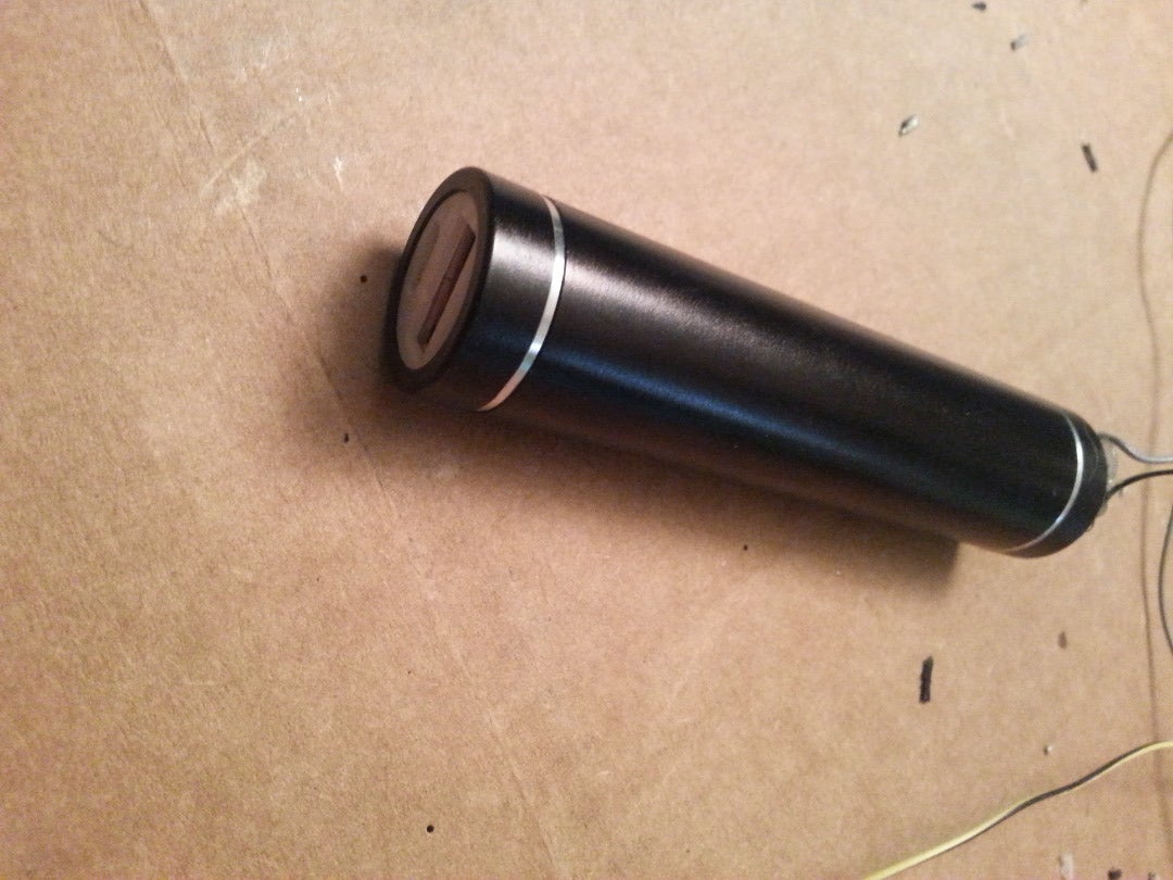

Step 2: The Battery
To power this sonic I minimally modified a portable phone charger that fit inside the handle of the sonic. By adding two wires to the USB connection I was able to tap into the 5 volt power source and still use the charger for its intended purpose, charging phones.
To save repitition I put these instructions in their own instructable: https://www.instructables.com/id/Rechargable-Batte...
Step 3: Placing the Battery in the Handle
With the battery done I expoxied it in place using JB-Weld and left those pieces alone overnight.

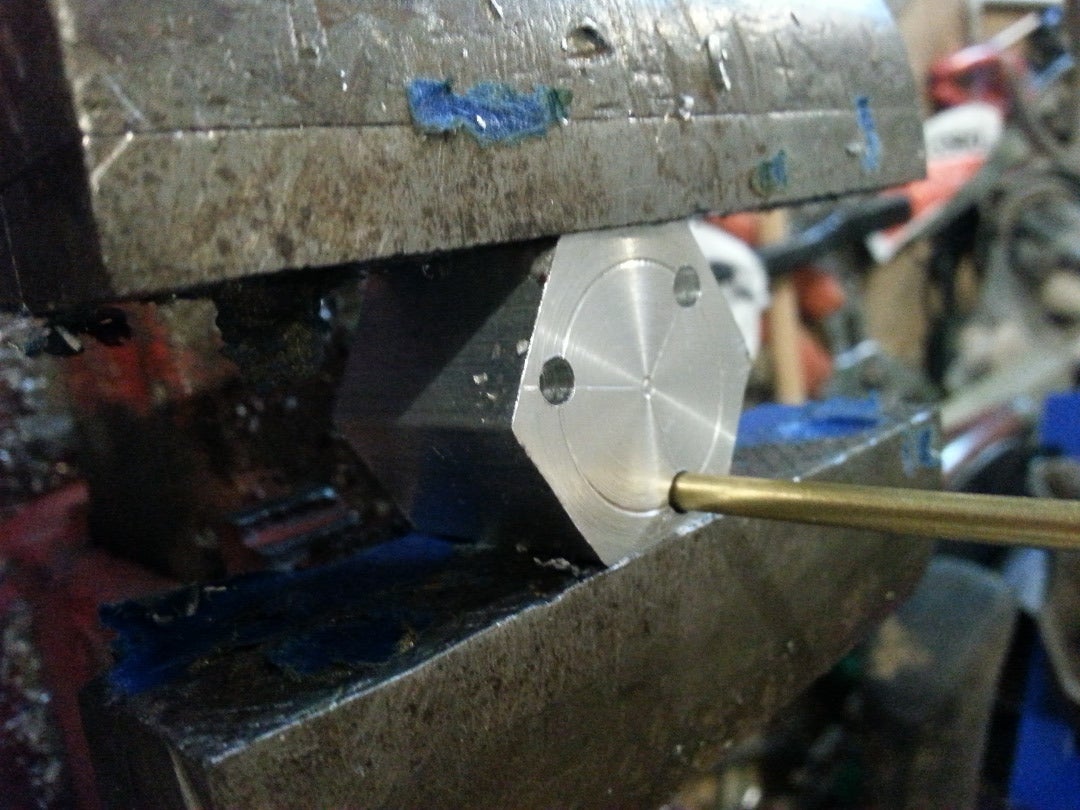

Step 4: The Handle Top
In my design, the top of the handle has three small brass cylinders that match up with the claws.
I started with a piece of 1" hexagonal aluminum in my lathe, cleaning the bottom face of the part
I then marked the part by cutting a small groove in the face with my cutting tool and used the headstock nut on the lathe to divide the part three times.
The holes were then drilled using an 1/8th inch drill bit
After turning down the bottom of the part to fit inside the handle, I drilled the centre hole big enough for the plastic tube I was using and machined the correct profile into the top of the part.
A bit of epoxy holds the brass rod inserts in place (not shown)
