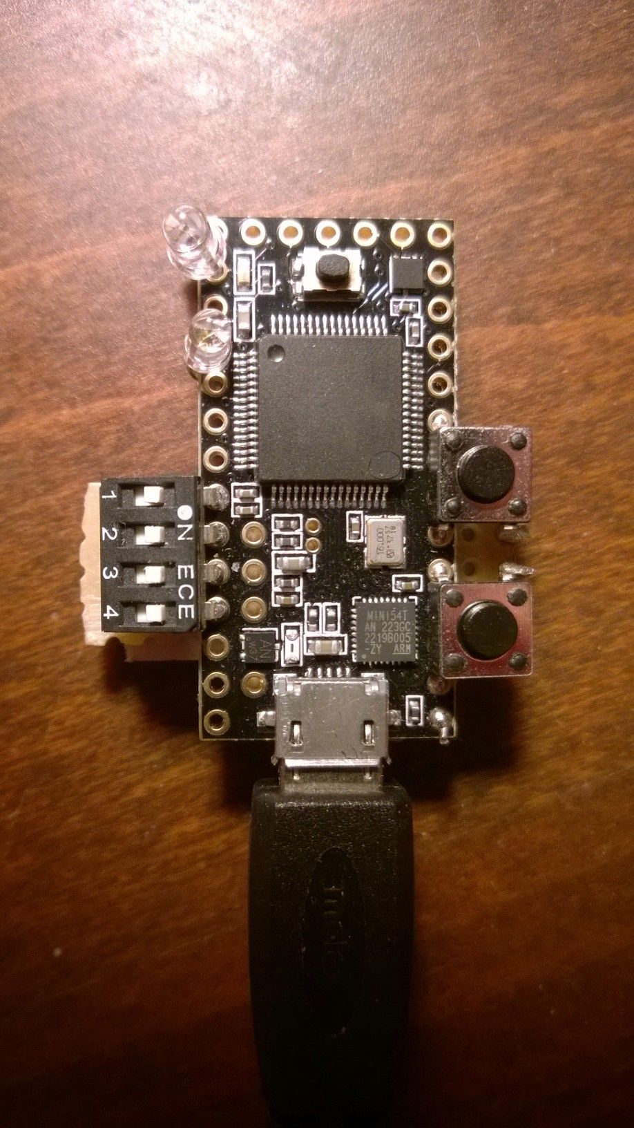

Step 1: Teensy Testing
So in this step we will just get the Teensy connecting to the computer.
Essentially, follow the instructions here: [http://www.pjrc.com/teensy/first_use.html]
Use the Teensyduino style of programming your device, for which there are further details here: [http://www.pjrc.com/teensy/teensyduino.html] (This will require the Arduino software [http://www.arduino.cc/en/Main/Software])
If successful you should now know how to open a sketch in the Arduino editor, compile it, download it to the Teensy and then run it.
If this is not the case then you should review the documentation in the links above.

Firstly, solder some header pins on to the Teensy so that it can be used in a breadboard.
The transmitter can stay as it was in the previous step.
Adjust the receiver to the following:
Receiver -> Teensy:
Pin 1 - MS2 - Teensy pin labelled "3.3V (100 mA max)"
Pin 2 - X
Pin 3 - IN1 - Teensy pin 0
Pin 4 - IN2 - Teensy pin 1
Pin 5 - IN3 - Teensy pin 2
Pin 6 - X
Pin 7 - X
Pin 8 - GND - First Teensy pin labelled "GND"
Pin 9 - Vd - Teensy pin labelled "3.3V (100 mA max)"
Pin 10 - X
Pin 11 - MS0 - First Teensy pin labelled "GND"
Pin 12 - MS1 - Teensy pin labelled "3.3V (100 mA max)"
The Teensy pin numbers and names are taken from [http://www.pjrc.com/teensy/card5a.pdf]
The receiver will be powered from the computer USB port via the Teensy, so there should now be nothing connecting the two transceivers.
The input pins on the Teensy are changeable, just make sure they are set correctly in the code.
Next the attached code should be loaded on to the Teensy and run. It can be copied as it is, to a sketch and then should run fine on the Teensy 3.0.
The code firstly defines the pins that are in use and their functions.
Then it declares a few variables for storing values, such as the input from the module.
There is also a timer set for debouncing.
The interrupt handler is called when an interrupt is triggered and then disables the interrupts, gets the input values and then enables the interrupts again.
The interrupt enable and disable functions attach and detach rising edge interrupts to the three input pins respectively.
The get input function simply reads in the three input pins and an optional button, then, after some debouncing, converts the binary input into a decimal integer. Lastly it uses the serial connection to output the result to the computer.
The setup function (unusual order I know!) sets the function of the pins (IE. Input/output), enables the interrupts and then flashes the Teensy LED to show that it's ready for use.
Overall, the code tells the Teensy to wait for an input. When it receives an input an interrupt is triggered - an interrupt is an event that causes the current program to pause whilst some other code is run. So in this case the program is doing nothing, then this nothing is interrupted and the interrupt service routine (ISR) is called, once this function has finished then the program will go back to doing nothing exactly as before.
Our ISR first disables the interrupts, this is so the Teensy doesn't try to run the ISR whist already running the ISR as this can get seriously messy with variable access and generally undefined behaviour... :-/
Additionally the debouncing thing... Debouncing is the mitigation of mechanical bounce. Mechanical bounce is the small amount of oscillation experienced by a switch. So when you turn a switch on it isn't just a simple off -> on swap, sometimes it happens that the two connectors actually hit each other and then bounce up and down before becoming stable, this is called mechanical bounce. In our design the switch connecting the rotary switch and the transmitter may suffer from mechanical bounce causing the input to be transmitted more than once, so a timer is put in the code so that if more than one input is received within 100 microseconds only the first will be accepted.
So essentially, the code will wait for an input, read the input and output it via the serial connection.
To view the serial output, when the program is running click the magnifying glass button in the top right hand corner of the Arduino code editor. This should display "RFD21733 Interface:" after the LED has flashed.
If this has all been done correctly then the serial display should print the decimal version of the binary input given to the transmitter.
If you are unable to open the serial display or the LED doesn't flash then the teensy code isn't running, try resetting the Teensy.
If the "RFD21733 Interface:" message doesn't appear then the input test code hasn't been downloaded correctly, try downloading it again.
If there is no output after the initial message then check the pins have been set correctly in code to correspond to the connections made with the hardware. {This should be set in the "Constants" section, directly after the "Define pin numbers" comment}
Alternatively, check the connections from the receiver to the Teensy, the power to the receiver, that the transmitter is turned on and is transmitting (the LED turns on).
If the numbers are showing up but the order doesn't seem to correspond to the binary input, check that least significant bit connects to input 0 and the most significant bit connects to input 2.

Step 9: The Receiver Board
In this step we will construct the receiver board.
This is a simple design for a bit of copper strip board to connect the receiver and the Teensy, so we can take them off of the breadboard. The connections can be seen in the attached photo.
Firstly, the wires need to be soldered into place.
Then the connections that aren't required should be routed out.
Finally, the receiver and the Teensy can be soldered in.
If successful the components should behave exactly as before, but now be mounted on a piece of copper strip board.
