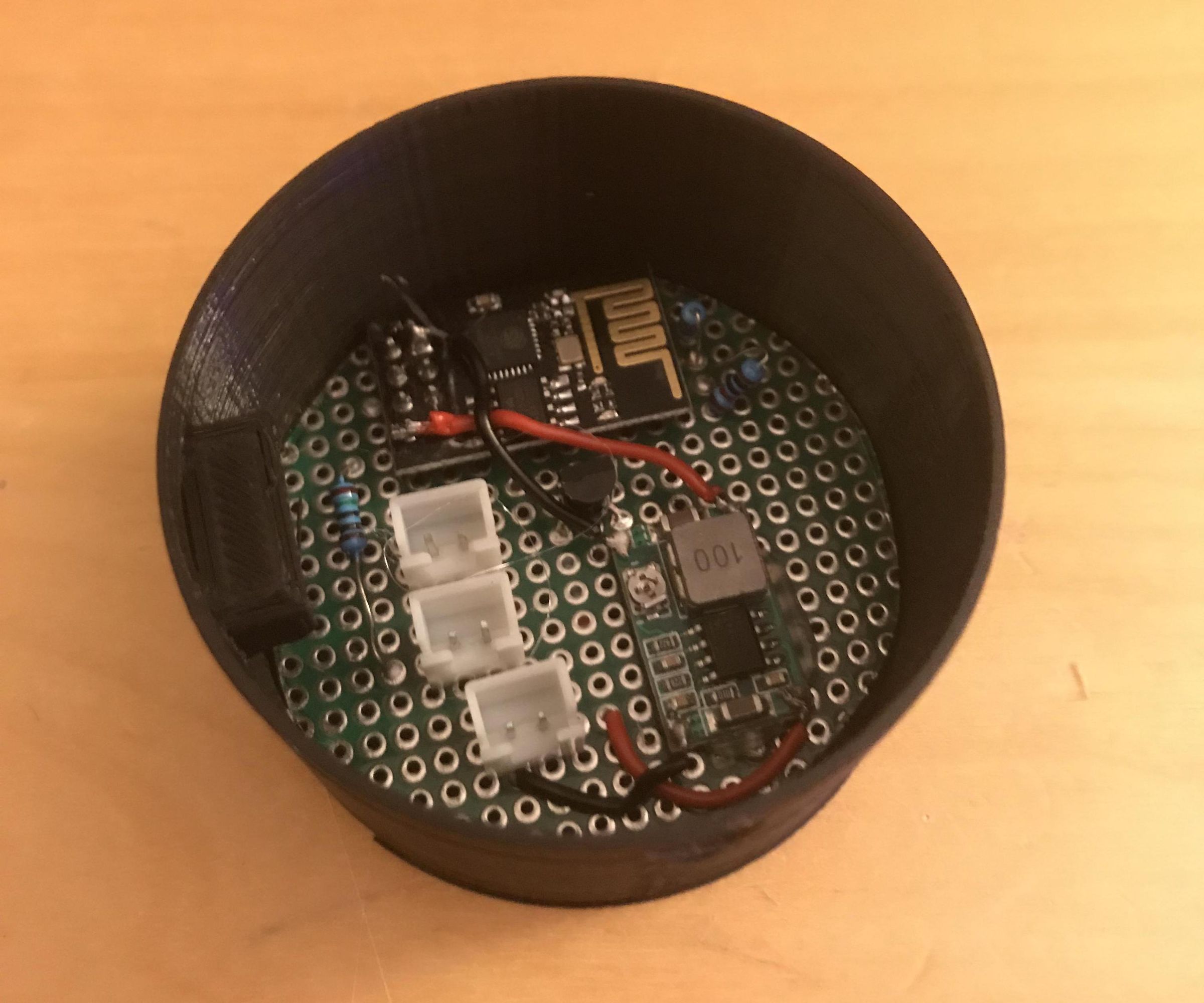

Step 3: Soldering Part 1
Now you have to cut two lenghts of 0.14mm² cable. I used about 10 cm, because I wanted to 3d print an enclosure for the new PCB at first, but I later decided to put all the components inside the old housing. Therefore I recommend to use e.g. 5cm. This should be definitely enough. Then you have to solder the red cable (+) to the right terminal of the voltage regulator. The black Minus-wire will then be connected to the left port of the AMS1117. This step would be easier if you tin the cables at first.
Step 4: Making the New PCB
Now you have to cut a small piece out of the PCB. Make it as small as possible. I used my Rotary Tool for this. Of course you can use an oldschool cutter :). Solder the circuit as shown in the scematic and hook the Input wires up to the Input terminals of the SONOFF Basic! Look at the video if you don' t understand what I am talking about :)

Tip 4 years ago
Have added photos to show where I soldered and show some ebay modules that are pre-built to drop 12v down to 5 v. For isolation from the AC voltage input circuit, I removed the diode bridge and PTC blue disc component. Hope this helps. Regards, Jim
