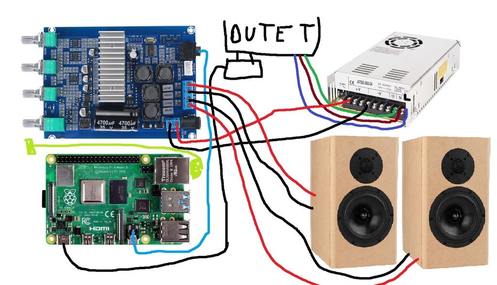

Step 7: Connecting Everything Togheter
The connection is different for every amplifier, but the principal is the same. This was my schematic, your's should look the same.
Power supply:
Connected to AC wall outlet.
Blue wire to N
Brown wire to L
Green/Yellow wire to GND
V+ --> DC + of amplifier
V- --> DC - of amplifier
Raspberry pi:
USB C to wall outlet
AUX cable to amplifier
(Ethernet cable to router)
Amplifier:
DC out - to speakers
DC out + to speakers
Eventually you will end up with something like in the image below. Now Everything should run fine and your new WIFI speakers are ready to play some music.
