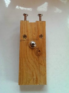

The Play 1 player has a 1/4-20 threaded mount 2 3/16" up from the bottom of the unit. This permits the use of standard hardware to mount the player securely from that point. After a few measurements of the Play 1, I fabricated a block of 3/4" plywood and used furniture bolts and barrel nuts to secure it through the floor of a kitchen cupboard. A 1" 1/4-20 bolt and washer hold the player to the block.
Step 2: Fabricate and Drill
The PDF drawing shows the dimensions I used for the block. (I'll explain the cut-out in an upcoming step.) The hardware you use will dictate the exact dimensions, but this shows how I laid out the cuts and holes for the 2 1/2" furniture bolts and 5/16" barrel nuts. I used a drill press for all the holes, but a hand drill with a steady hand would work well, too.
The notch at the top of the block let's the power cord pass through the block unimpeded.
I attached the block to the player and positioned it under the counter where it would be installed. I marked the edges of the block where it contacted the bottom of the cupboard, then measured off for the holes for the furniture bolts. The bolt holes will be drilled from the bottom of the cupboard up into the cupboard.
I placed a block of wood inside the cupboard to prevent tear-out when the drill bit penetrated the floor of the cupboard, and drilled the holes for the bolts. I then drilled countersink holes for the heads of the bolts so they would not protrude above the floor of the cupboard.
Note: When drilling the countersinks, be careful not to go all the way through the cupboard! Drill just deep enough to recess the head of the bolt.

The player as an Ethernet port, a power cord and a 1/4-20 mounting point near the bottom of the unit. There are buttons on top of the unit for play/pause and volume control. By installing the player upside down, it fits right up underneath the cupboard and permits access to the controls. In this install position I am not using the Ethernet port, so it is covered by the bracket. If that port is needed, drill a hole in the bracket to accept the Ethernet cable.
Attach the bracket to the player with the 1/4-20 bolt. Make sure the bolt doesn't "bottom out" in the mounting hole; this could cause the player to be loose in the mount.Use washers to shim the head of the bolt to give enough threads for a snug fit.
Insert the bolts into the holes in the cupboard. Insert the barrel nuts into the bracket and orient the holes vertically. there are markings on the barrel nut to show the orientation of the threaded hole for the bolt.
Make sure the power cord is in the channel cut for it, and slide the bracket up onto the furniture bolts. Thread the bolts into the barrel nuts and tighten them so the bracket is snug to the bottom of the cupboard.
