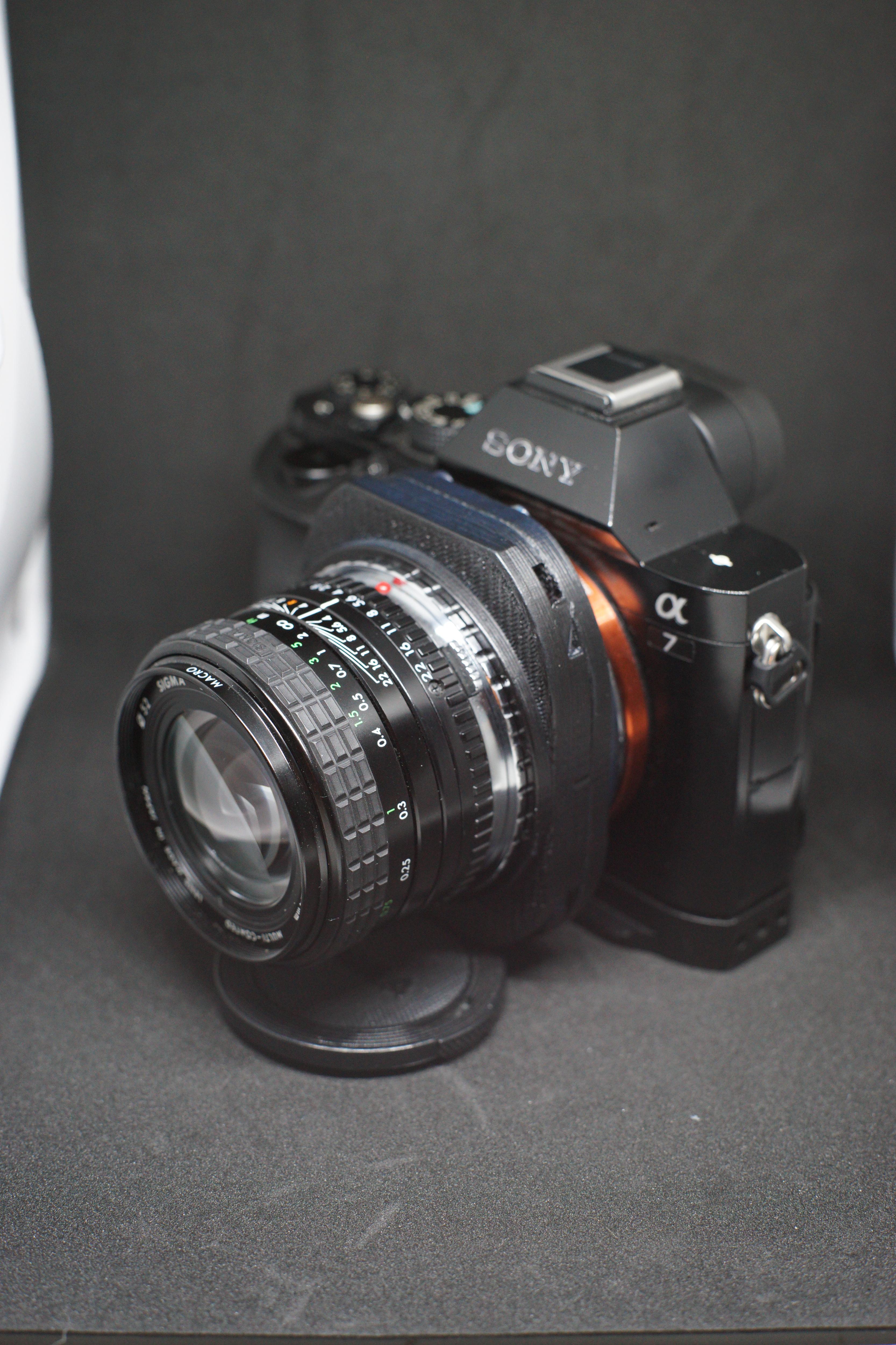

This is guide showing how to build a limited shift adapter for some(see test fit section) Sony E Mount cameras. It can be used to get some nice straight Architectural photography, without tilting your camera up.
It is mostly 3D printed, requiring some 3mm nuts and bolts and some tools that are not hard to get.

Step 7: Test Fit
So now you have it together, does it slide up and down?
Don't have the nuts on the reverse too tight, it may lock in place. Its up to you how muck friction you want.
As shown in photo, I added some matte black flocking to the inside of the E mount part to limit reflections.
When mounting to the Sony A7 (mki) the adapter just about rotates onto the camera, one of the nuts on the back side of the rear plate barely clears the camera grip as shown.
I do not know about clearance here on other camera bodies, unfortunately. The late a7 cameras may have bigger grips, the Sony APSC cameras may be shorter grips.
It might be possible, after final gluing (next step), to remove that particular nut and bolt and have the slide retain its strength?

Step 10: Results - Does It Work?
It does.
The two set of photos show 3 pics
1. Camera level on tripod. But the top of the building is cut off by the lens not being wide enough.
2. The lens is shifted up using the adapter and the vertical lines remain vertical, and the top of the building is brought into view.
3. The tripod is tilted back to get the top of the building into view, but the vertical lines converge.
(By the way this 21mm lens is not the best, you can see all sort of other distortions in the photos!!)
These aren't the greatest examples, we have the 2020 lockdown going on here, so I can't travel far. I will try to get out and get some good tests.
