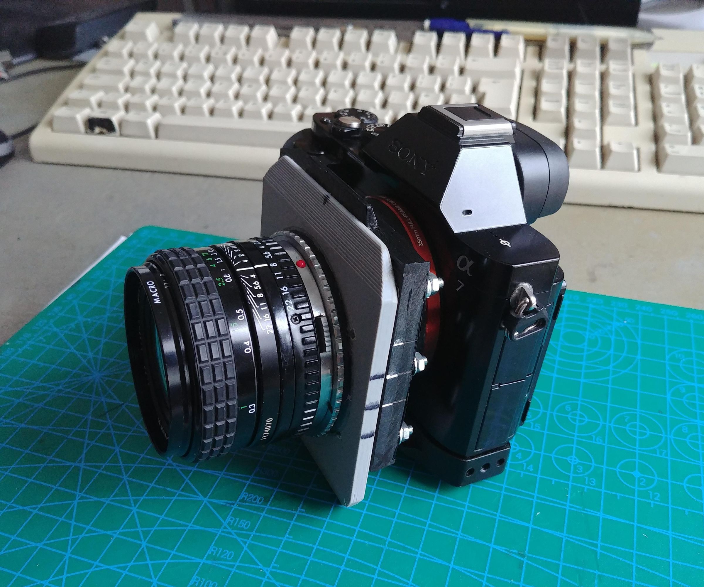

This is an updated version of a 3D printed Shift adapter for Sony E Mount cameras. Its simpler than the previous version:
https://www.instructables.com/Sony-E-Mount-Shift-Adapter-3D-Printed/
This one uses only three 3D Printed parts and 2x 3mm screws.
The front mount is for Canon EF EOS lens fittings, which can be adapted to many vintage or manual focus lens mounts types.

Step 1: Print You Parts
Print as per the images.
I printed in PLA. The slide ways needed some cleanup of support material.
Some of the surfaces might need some wet sanding to make them smooth.
You will need to tap the 2 holes in the 'Lower' part for m3...or Just force your m3 screws into the plastic and they might make their own threads!!
Step 2: Assembly
Assembly should be easy.
Slide the 2 main parts together and attach the small 'Bit' with the 2 m3 bolts or glue it on.
The slideways of the parts may need some extra sanding and cleaning up to get them so move over each other smoothly.
When this is ready you could add a small amount of grease or other lubrication to help the Slide action.
ATTENTION : Clean up of the Sony mount area is very important. There can be no loose bits of plastic or excess here. The camera mount PINS are very delicate. There is enough clearance in the print, but DOUBLE check everything is cleaned and looks good before attempting to fit to the camera body. And go slowly, don't force anything as you attach it. If it doesn't want to go or doesn't feel like it wants to fit, just stop.
Step 3: Finish
Add a lens mount Adapter to suit the lens type you have, here I have used an Olympus OM to EF adapter. I used a small blob of UHU universal glue to keep the OM adapter in place.
You can slide the Shift adapter up or down, by hand, by up to 10mm to correct perspective.
Hopefully the 'Slide Action' is tight enough to Hold position when you are shooting, if not, you may need to keep a hand on it.
