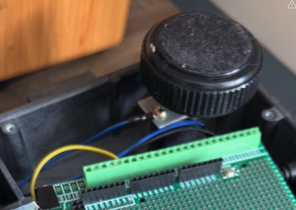

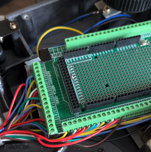

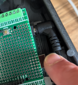

Step 2: Install New Arduino Mega2560
Install Arduino Mega2560 Board and prototype board

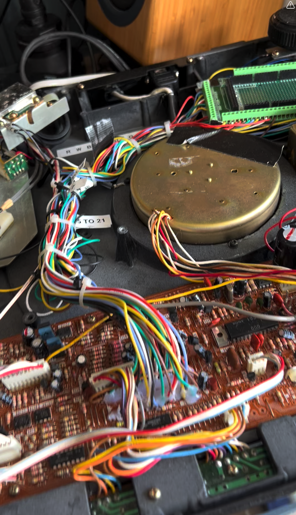

Step 3: Wire the Loom From Sony IC Socket to Arduino.
Wire The Loom To From IC Socket To Arduino following the pin to pin guide in the image.
Added an earth from the Arduino GRND pin to the Sony Chassis - you can see this in the top left of the pic, fixing point just under Sony Foot.

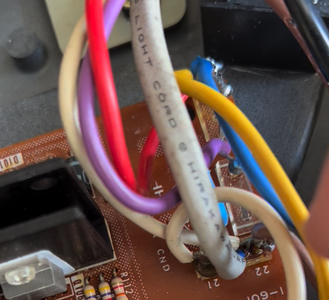

Step 4: Light Sensor Board
I did have to replace the onboard Light Sensor board which detects the Size of record being played - As I'm using an external light detection i've added Embrio Agent/Hardware to ascertain record size - the code would need tweaking / changing to pickup the digital default pins 30 / 31 From Sony Light sensor board, but if you have got this far - this shouldn't be a problem for you :) to tweak the code back to Pin 30/31.
The homemade light sensor board is connected to analog pins on the Arduino - Pin 10 for 30cm and Pin 11 for 17cm
If you are using the Sony Standard light detection and it still all works - these get connected to Pin 30/31 on the Arduino and you'd need to change the Embrio software

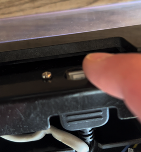

Step 5: Install External USB Port
Install an external USB extension port for uploading software and configuration to the Arduino from outside the record player.

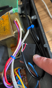

Step 6: Install 9v Block - Step-down Transformer
Glue in a 9v step down transformer powered from the Sony switch and connect an external DC Arduino cable to the block and plug into the Arduino.

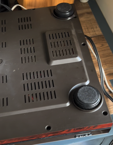

Step 9: Screw Base Back Onto the Record Player
Screw Base Back Onto The Record Player - I did have to trim a bit of plastic off the top right foot entry hole as this was just catching on the Arduino - used a Drimmel to grind about 5mm off the plastic inner cone.
